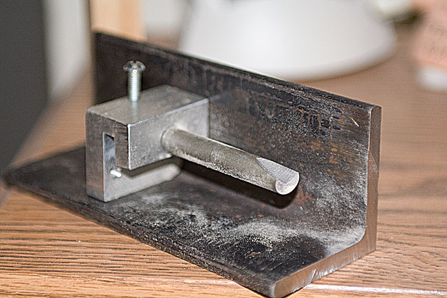

I just built one that uses the 1/4 inch pilot shafts from a pen mill. I can use any size 1/4 inch shaft I have now by undoing the setscrew and changing the pilot shaft for another. Pretty handy way of using both methods as needed.

Like Gary's jig, this is mine.

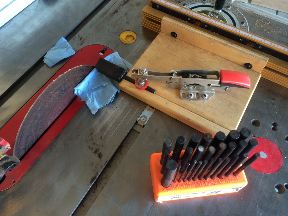

I built this using a V-Bit. I turn the blank on the nearest sized knock out bar. Used with an Inca HD 1000 and Bessey hold down clamp. I get perfect square fits and never take off too much wood, especially for click pens. The shop towel was added for background to the Macassar ebony blank.

Oh that is going to scare a lot of people:eek:
Pete
I respectfully disagree.
How long have you been a member here??? Any time people mention tablesaw there is this fear for many here. The reason is you are dealing with such a small piece of wood near a spinning blade and the thoughts of getting fingers that close. Now many have gone on to making jigs to hold these pieces of woods and then of course there are those that are more woodworking savvy and know how to work around these machines. With the jig he shown there is no failsafe system to hold and control that piece around a high speed turning object which can do as much damage to you as a blade. These sanding discs have been around for years but are not widely used for various reasons.
For what we do, sanding on the lathe with a similar system and the use of the turning plate is alot safer. You can slow the lathe down which is a huge plus. You do not want to be sanding at those speeds. Even using a dedicated sanding station with disc is safer than that. Safety is what it is all about when working around machines and in a shop. This is just my opinion and I would not do it for what we do.
I started out squaring on my disc sander with the PSI Jig. I didn't like their jig for a few reasons. The biggest problem is that while it's very easy to square the mitre square to the disc, and the jig itself to the mitre square, the mandrel protruding from the jig is very difficult to get and keep square. It's a single point of attachment to the vertical piece of the jig. Also, once you get it square, you don't want to take it off to put in a different size mandrel.
After using the setup I posted earlier this year with the pipe centering jig, I'm happy to report it's worked perfectly for me. I've never had such consistently square blanks.
