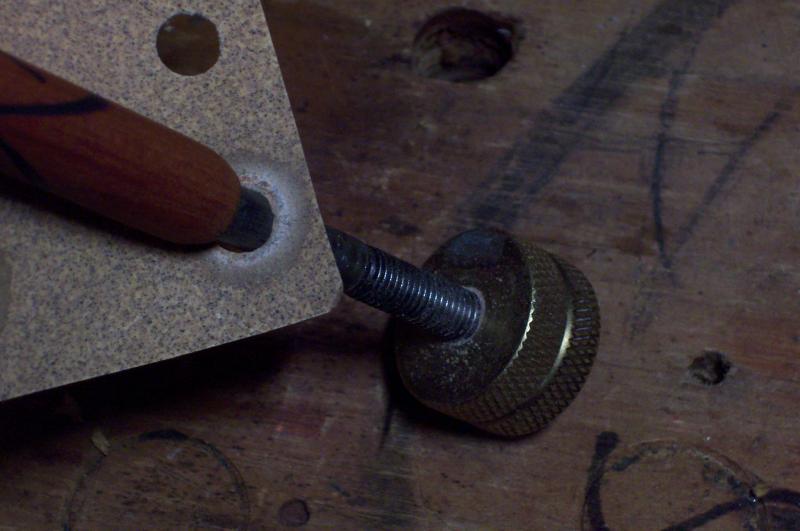

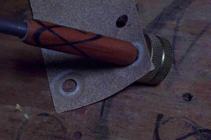

Here is how I do it with great success.
One old mandrel. Some sand paper your choice of grit. One hole puncher. If you are doing tubes bigger than 7mm then make some adapter tubes starting with a piece of material with a 7mm tube glued into and then turn to correct size that fits inside the bigger tubes. You will have to make one for each different inner diameter. With this method you don't have to glue any paper to anything just hold paper and mandrel nuts and turn blank. It is easy and cheap. And your end product will be greatly improved.
