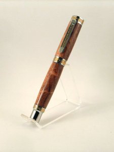

Spring Blossom in Figured Mesquite
See more from pianomanpj
Really nice pen.
Could you tell us a bit more about this new kit from Timberbits? - any issues? Does it feel cheap? or on the contrary, is it a good deal?
This kit is somewhat similar to the Empress, a new kit in the same price range offered by Axminster in the UK, but according to some feedback here, there seems to be quite some issues with it. Just want to check about the Spring Blossom that came out at about the same time, but on the other side of the planet. :wink:
Good looking pen. How do the components feel to you, quality wise? Is the centerband assembly all plastic, like the similar Emperess?
Very nice! Who manufactures this kit? Dayacom?
I don't know who it is, but I highly doubt it's Dayacom, as it is a knockoff of their Emperor.

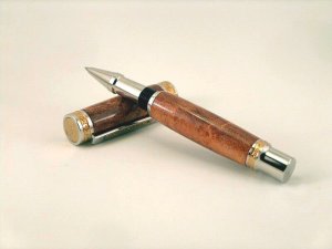

To be honest, I have mixed feelings about this kit. I like the overall look, but there are a few things of which I took note.
Before I go ANY further, please bear in mind that this is NOT a reflection of David at Timberbits, nor his representation of this kit! As far as I'm concerned, David is a standup guy, and has a fantastic business practice. With that said...
1. The center band coupler required a little cleanup as the threaded plastic insert is glued into it and some of the adhesive ran on the portion of the metal fitting that gets pressed into the tube. Please note that there was NO adhesive on any of the finished surfaces.
2. The center band coupler's trim ring and retaining ring (my terms) fit loose on the center band while not assembled, but fit secure when the pen is pressed together. I only made note of this since almost all the other pens I build requires effort to separate the trim and retaining rings from the center band.
3. The weight of the center band seems light in comparison to that of other pens whose center band's base metal is brass. I could be way off on this, but that was my impression.
4. The threaded portion of the center band insert is quite long, and if you over-tighten the pen into the cap you run the risk of the nib fitting (and associated bits) be pulled out of the tube.
I can't stress enough that these are just a few things that I noticed while assembling this pen, and that none of them I would consider "deal breakers". As I said, I like the overall look of the pen.
One thing the bear in mind is that this kit is made on mainland China. (Infer what you will.) David does NOT hide that, and in fact, states that reason as one of the ways as keeping the costs down.
I won't be selling any as of yet since I want to hear other opinions first and see how the one I built for myself holds up. Especially the plating. It certainly looks like a high-end pen, but I need to be sure it will perform as one so as to get the high-end pen price.
I DO want to commend David and give him an "attaboy" for bringing this pen to the market at this price point. I know it takes a LOT of hard work to pull off something such as this. And although I would personally change a few things, I would definitely say that he is on the right track.
I would strongly urge anyone who is interested in this pen to buy some and go for it! The kit is very inexpensive, and for the those who are inclined to modify their pens, this kit lends itself well (Observation #2).

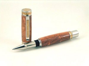

I think it would be difficult to convert this pen into a fountain pen. The tube for the pen body is much smaller in diameter than the turned pen body. (I have never seen any other pen that leaves so much material on the tube!) Although I haven't measured the pen body tube, I would estimate that this tube has an I.D. of 8 - 9 millimeters. (This is from memory, folks. I'm at the office at the moment!) I'm not sure how well the tube would accommodate a pump converter, cartridge, bulb, etc., even if you DID replace the nib! (Of course, I've been known to be wrong! :redface:) If someone has this kit, calipers and the inclination, could you post the I.D. of the tube for the pen body? Thanks! :biggrin:
I agree, the pen body has an unusually small tube diameter (11/32" drill bit), but so does the Axminster's Empress (11/32" too) which is available both as a rollerball and a fountain, so that must be just enough for the purpose. I bet that if the kit sells well David will offer other platings and the fountain option.
I've got three kits on the way... :biggrin:
Hi Roger.
Great looking pen.
Thanks for that honest opinion on the Spring Blossom.
Regarding the Fountain pen, when we first originally designed the pen, one of the design requirements was to leave as much meat on the tubes as possible. This makes turning much easier and gives the caster much more room to play with. Unfortunately we couldn't do the same with the lid because reducing the diameter of the lid tube meant that nib section of the pen looked too slim and out of proportion.
Everything went well and I was really happy with the outcome (factory only sent me the rollerball to check the production). I have thousands of the spring blossom half of which is the fountain pen.
After making the rollerball everything was sweet. Making the fountain pen everything was sweet as well. When I make a fountain pen, I don't put the cartridge or the plunger unit in until I want to use the pen or just before I give it away.
Disaster, just before going to a party (fountain pen and rollerball as presents) I discovered that the ink plunger unit would not fit into the nib coupler.
The inside diameter of the nib coupler is too small for all the plunger units and most of the disposable cartridges but about 1mm.
I have held onto the fountain pen and sold the rollerball. I have looked into messing around with reducing the diameter of the coupler but it looks like a no-go. I will get this kit redesigned in the middle of the year with a slightly larger brass tube to over come this issue.
Let me know what you guys think. Sorry in advance about hijacking the thread if it goes that way.
Regards
David
