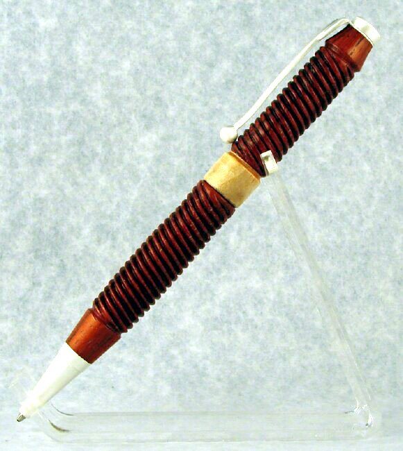

Here are some spiral cut slimlines that fell off my lathe today:
Sheaoak...

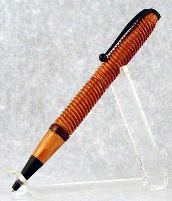

Padauk with a maple band...

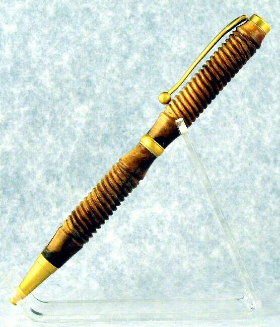

Spalted box elder...

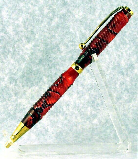

Acrylic...

The process is: turn to the final dimension, sand completely, cut the spirals, then buff using the Beall system. Also, the wood has to be hard and fine grained for this to work well. Comfort...I like textured pens that don't slip in your hand, so these work well for me.

Wonderful job on the spirals! [:p] Was it any more difficult for the acrylic as opposed to the wood? Were there any differences in finishing or technique?

Yes, the acrylic was much more difficult to buff out than the wood...but with enough Tripoli, you can defeat just about any pesky sanding or cut marks.
