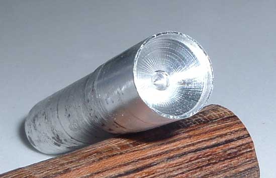

This is a short piece of aluminum stock that I used as a test.
The OD of the aluminum is .465" and I drilled into it about 1/8" with a 27/64" drill bit.
My scroll chuck is a new G3 with pin jaws and it works great.
The thickness of the rim varies between .0215" and .0225"
With the scroll chuck mounted I can see a runout of about .0015" and I get he same reading with the dead center installed. This seems consistent with the thickness variance above.

Would a runout of .0015" be acceptable? Who has checked theirs and has more or less with no issues?

I have a Jet 1642 and the runout on the inside of the spindle is less than .001", same for the spindle backplate. I consider this VERY good for a wood lathe, your .0015" is also very good...don't change anything!:biggrin:
