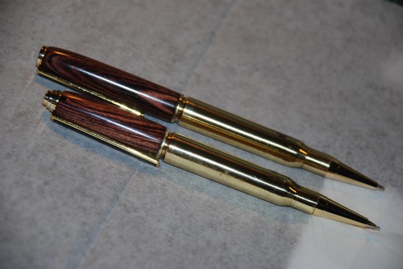

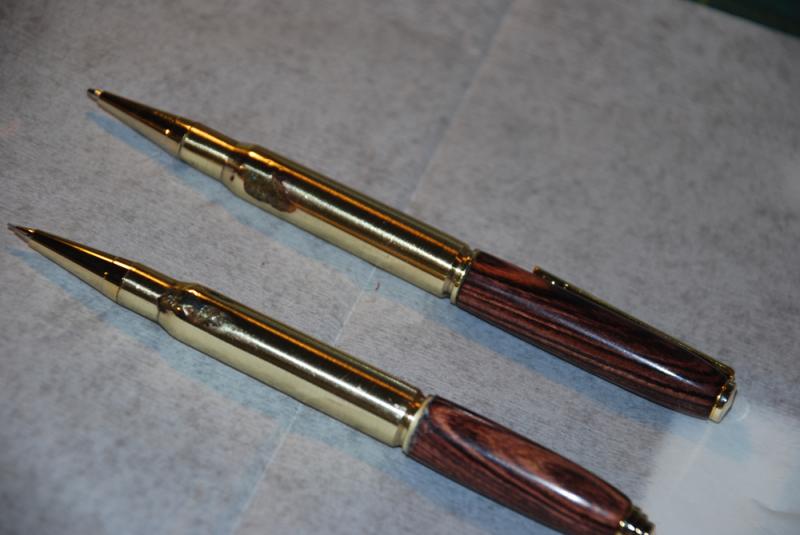

Here are the pictures of the finished and finessed pen and pencil set.
The blems in the bullet were where the corrosion ate through the bullet.
John, the blemishes can not be held against the craftsman when the customer insist on using defective material. Other than the wear and tare on the brass, you still came out with two good looking results, congratulations.
Charles
