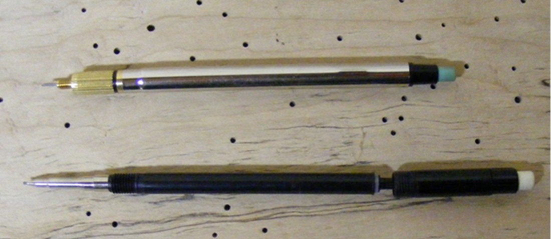

karl, where did the kits come from? The reason I ask is I've seen two different mechinisms on the Euro pencils. One is like the Cigar, twist in one dirrection to extend the lead and twist back to lock it in place. The other you twist in one dirrection to extend the lead (the more you twist the more comes out) and twisting in the other retracts the lead.
The former was from WoodPenPro and the later was PSI.
The PSI kits I believe you have to load the lead in through the nib and rotate it alll the way back in (or at least twist the mech all the way back, then put the lead in through the nib.) I couldn't figure out any other way to change the lead.
I have both mechs at home and can take a picture tonight to show what I mean. I stopped making them both as neither is all that nice and the kits themselves were a pain 8mm for PSI and about 8.5mm for WPP.
I also have one kit for the Berea double twist Euro that I haven't finished. It's a pain in the butt to. There is a reason that I've stopped doing Euros all together.
Here are the two mechs, the top is bothg the PSI 8mm pencil and the Berea double twist (although on the Berea kit, the 8mm tube then goes inside another tube). The bottom is the WoodPenPro mech.
The WPP mech is a self feed, but the PSI/Berea I don't see how it can be. I do like the action on the PSI/Berea mech better than the twist-twist back movement (similar to cigar pencils) on the WPP kit though.
