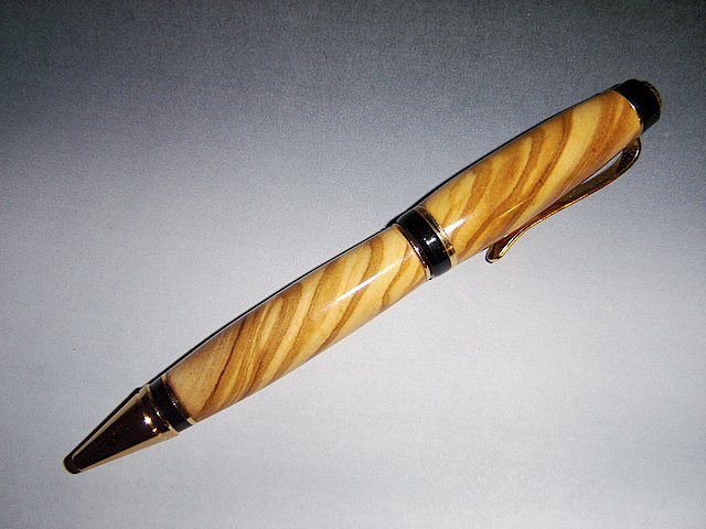

K ken69912001 Member Joined Mar 19, 2006 Messages 965 Location Crawfordsville Indiana Aug 14, 2006 #1 This wood I just recieved and dried a piece in the microwave to turn. Turns like butter. Again in Ti Gold with CA finish.

hilltopper46 Member Joined Jun 28, 2006 Messages 2,420 Location East Troy, Wisconsin, USA. Aug 14, 2006 #2 Very Nice!
Boomalia Member Joined Jul 27, 2006 Messages 62 Location Cochrane, Ontario, Canada. Aug 14, 2006 #3 You just have to love olive wood.
Jim15 Member Joined Dec 20, 2005 Messages 21,371 Location Hamilton, Ohio, USA. Aug 14, 2006 #4 Very nice pen.

Jerryconn Member Joined Mar 30, 2006 Messages 1,006 Location Wirtz, Va, USA. Aug 14, 2006 #7 Awesome looking pen []
P Penmonkey Member Joined Aug 4, 2005 Messages 1,501 Location Boerne, Texas-The Greatest State, USA. Aug 14, 2006 #8 Very nice looking pen.
johncrane Member Joined Jan 17, 2006 Messages 9,743 Location Melbourne, Victoria, Australia. Aug 14, 2006 #9 LOOKS GERAT KEN []
K kkwall Member Joined Jun 12, 2006 Messages 868 Location Melbourne, Victoria, Australia. Aug 15, 2006 #10 Lovely wood, lovely finish, excellent pen!
tseger Member Joined Nov 27, 2005 Messages 613 Location New Albany, MS, USA. Aug 15, 2006 #11 Very nice pen! Does the SOW have the same fragrance as the BOW?
carverken Member Joined Jan 21, 2006 Messages 138 Location Manassas, VA, USA. Aug 15, 2006 #12 one word......sweet
O OSCAR15 Member Joined Mar 14, 2006 Messages 479 Location Winder, Ga, USA. Aug 15, 2006 #13 KEN BEAUTIFUL PEN ! How long did you nuke the wood? What setting?
K ken69912001 Member Joined Mar 19, 2006 Messages 965 Location Crawfordsville Indiana Aug 15, 2006 #14 Oscar When I nuke pen blanks I first drill them out then nuke on high for 20 sec. Then let cool and do it 4 times. No cracking yet. You may have to run your drillbit through to check your hole.
