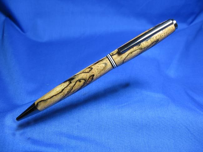

Black Chrome (or gun metal...I forgot) plated slimline with spalted Pecan and CA finish. Enjoy and as always, comments welcome.

Now that is another of one of your very nicely made pens. Looks like a custom CB, and everything else is great of course. What stumps me is the picture. I looked at it pretty closely, and it doesn't look like an editing trick, as in cut and paste, add drop shadow. So what's up, besides the pen?

Let me make a wild guess...there looks like some photo editing just below the nib (paint brush). Was the pen on a wire inserted through the nib and held by a base below the cloth. Then the wire was painted out?

RT: The pen is floating and it is not a photo editing trick. I'll share it.

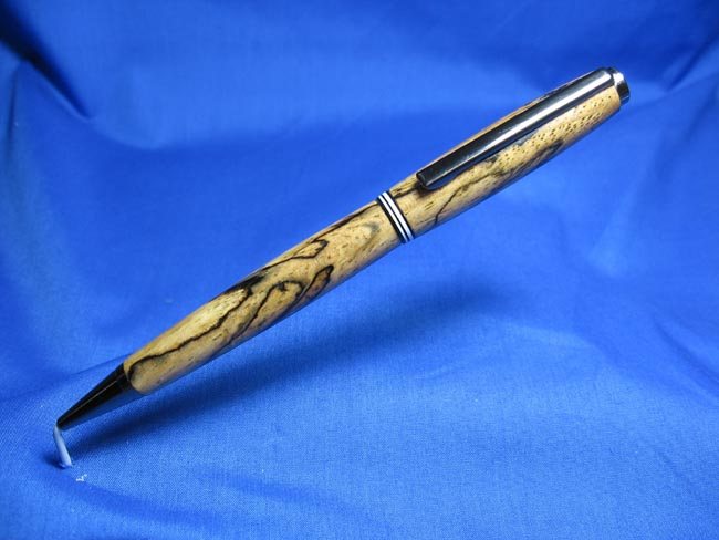

Tim: If you look close at the end of the nib you will see a little photo editing I did to hide the floating mechanism. I stuck a piece of wire in a board and placed it under the blue cloth and poked the wire through the cloth. I bent it about 60 degrees and placed the pen nib hole over the wire end. Lighting from the top created the shadow and I tried to paint out the wire with the clone stamp using photo shop. Lots easier that extracting the pen image and recreating it in photoshop and then creating a drop shadow. I think the effect is almost just as good. I attached a picture of the undoctored picture. Thanks for looking and inquiring. Glad to share.

The wire doesn't take away from the picture does it? I may just start leaving it or bunching the cloth around it and not retouching at all. thanks Tim.

I like the pen. Great grain. Cool CB. Is it glued to the top section or does it float? I like you photo creativity. If you pushed the blue material right up to the nib I think It would still appear floating without having to do any editing. Nicely done!
The pickguard is drilled and glued to the end of the top blank and turned with the pen. I really like picguard. It comes in other colors. I will try pushing the material up and around the wire next time and see how that looks.
