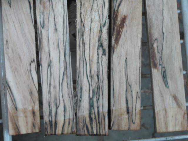

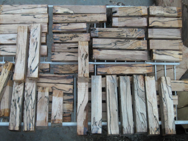

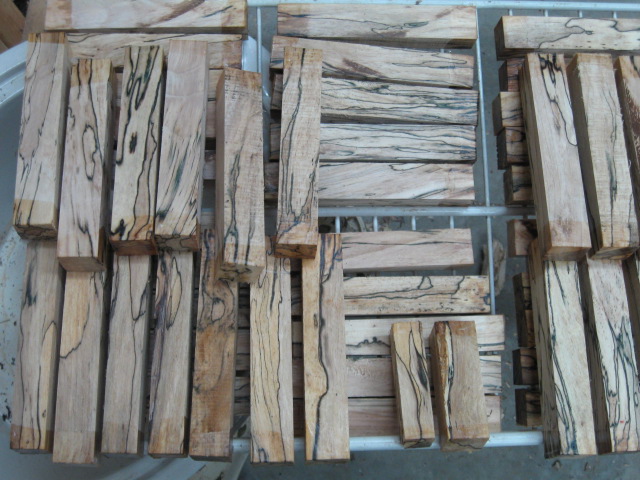

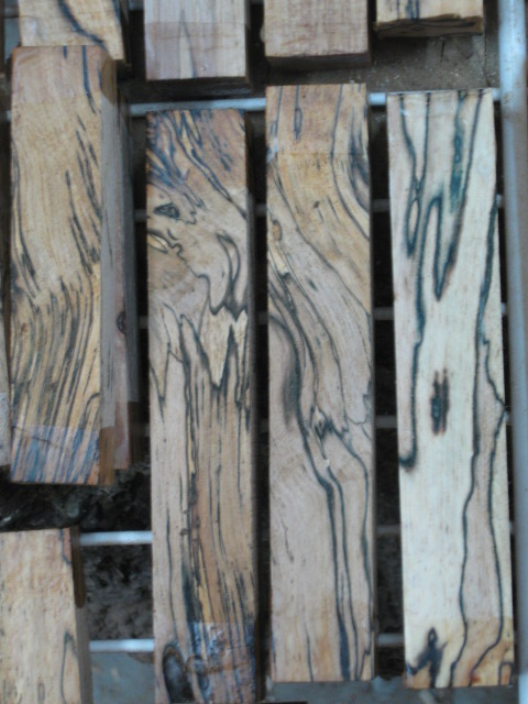

Here are some of my freshly cut pen blanks. It's been a good summer and my spalting woods are doing very well. This pecan has some tremendous lines and is very solid. Should make some awesome pens. I have my Maple to get to now.
