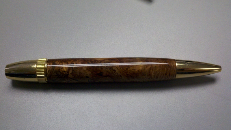

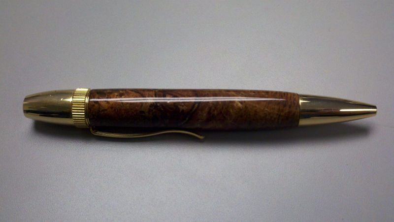

Sorry for spamming the boards with a pen I just made, but it applies to this topic.
Made this from rotten spalted punky oak burl from a firewood pile. I used a lot of CA glue (thin) and squirted in the voids as far as I could. Did this twice while turning, letting it dry naturally (no activator) for 10 minutes or so. Then soaked again with thin before applying 20 or more layers of medium CA then finishing.
The wood had fairly large pockets of punky wood that would just fall right out, you can see the tube in a few places but goes OK with the gold hardware.
