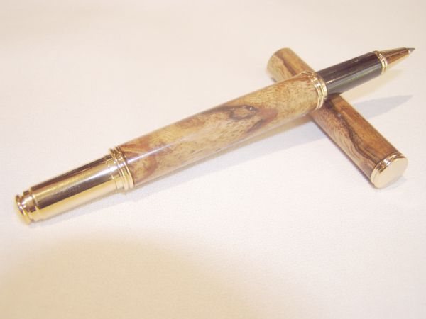

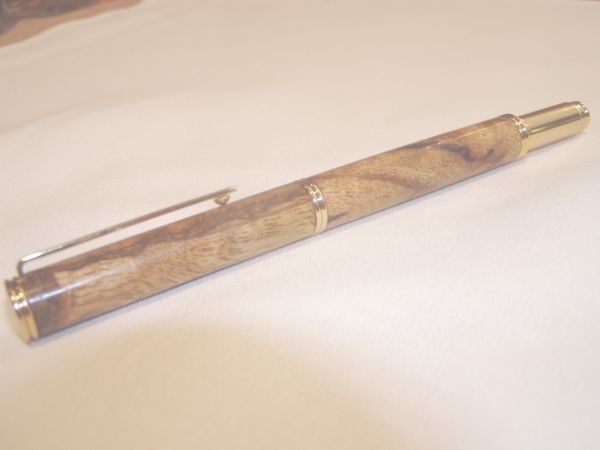

It as been a long time I started this pen and that was before I use CA ( December 2004 )allway scare to ruin the pen, so last night I did finish it, do we have any information regarding how to spalted our own wood in the IAP site, any info would be apreciated.
Thanks
Serge
Serge, it came out great! Nice job!
