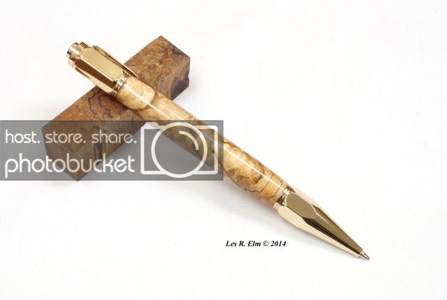

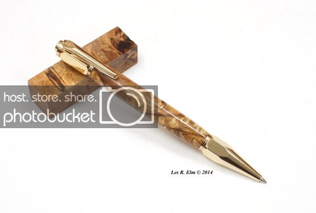

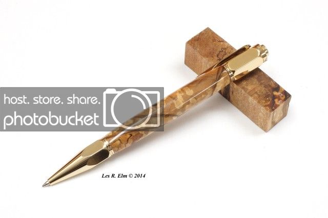

Dressed up in a Vertex Click with gold plated components.
Sanded to 400x, buffed with extra fine steel wool, applied 8 coats of Med CA, buffed with extra fine steel wool and polished with Huts Ultra Gloss.
Apparently as discussed on some of the pen turning sites, there has been issues with the click button breaking off of the plastic click mechanism threads if the pen has been dropped.
I Inserted a round wood toothpick inside of the hollow plastic plunger section of the click mechanism to help reinforce the threads.
IMHO, if the plastic click mechanism plunger was made for solid plastic there wouldn't be an issue.

good work! that's a dang good idea to reinforce the hollow click mechanism. I've lost several vertex pens due to breakages, now I'll maybe make the rest of them.
