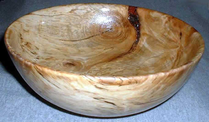

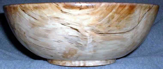

Here's a Spalted Maple...

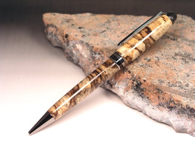

Awesome pen!

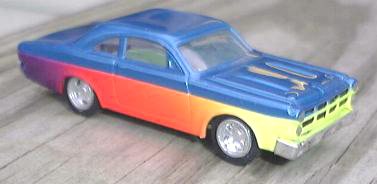

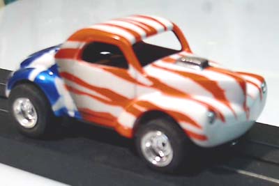

I am going to custom paint a couple of pens once I get the hang of turning. Painting on the small is nothing new to me.....
<br />
<br />
<br />
All are HO scale car bodies. Sorry for the blurry pics, cheap camera.

Lou is right about the spalt (of course). One thing that is interesting about spalt, OK 2 things: the black lines are present in white spalt and represent the edges of the micro-organism colonies. It is called white spalt, because the area inside the lines is usually kind of bleached out. The other one is blue spalt, which is blue, or any number of other colors. There is a peach colored spalt, which might be blue spalt. It is present in mango.
