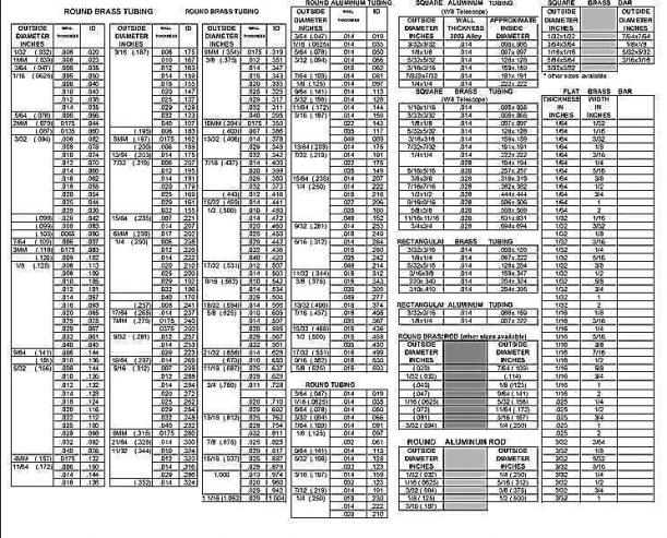

I have even gone as far as contacting K&S Engineering and they dont make one that you can substitute. They list a 10 mm on their site but not a 10.5. Are you looking to match the OD. or the ID.? http://www.ksmetals.com/resources/cuttolength.pdf You can print this and check to see if they have something you can work/live with. Mike
Here is the chart from K&S where he gets his tubes. You should be able to order from someone in the states close by, Im not sure what it costs to ship from Canada. this is the chart from the link in my earlier post
