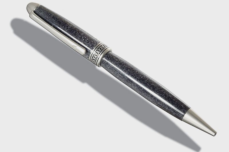

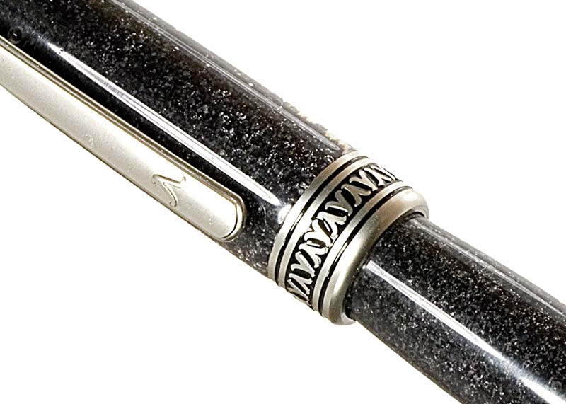

Here is my first casting. I got the idea from a previous posting were someone made a cast with sand and the toos barely cut it. The sugestion was to cast the tubes with sand and here it is.
As far as the picture goes I don't need to say where the idea came from. THANKS KIDDO.
Sorry here is the pen
<br />
Very nice!!!
Great pic!!!
One idea. Since it looks like you managed to separate the shadow from the pic, try using filter&gt;blur&gt;gaussian blur to soften up the shadow some.
Also, play around with edit&gt;transform&gt;skew or edit&gt;transform&gt;perspective to alter the angle/perspective of the shadow. Also, on the shadow layer, play with the fill control on the layers palate.
If you are using the layer&gt;style&gt;drop shadow controls to move the shadow away from the pen, insted try right-clicking on the little "F" in the layer after you add the drop shadow and choose create-layer. This puts the shadow on it's own layer and you use the edit controls I mentioned above to adjust it.
All and all, a FANTASTIC pic!!!!!
Would like to see more!

Wow, great looking pen? I cast sand in PR and tore up my tools turning it. Hadn't had a chance to try anything else. Did you use CA or some other adhesive to stick the sand to the tubes?
Originally posted by Stevej72
<br />Wow, great looking pen? I cast sand in PR and tore up my tools turning it. Hadn't had a chance to try anything else. Did you use CA or some other adhesive to stick the sand to the tubes?
Your pen was the one that gave me the idea. I remember you recent post. Thanks for sacrificing your tools for us to find the way
I used photo mount glue the one that you spray. Being my first cast I did not experiment a whole lot with it. I cast 4 tubes, 2 for this pen and 2 with white glitter, for the later I used contact cement and that gave me a bit of a more uniform thickness layer since the spray glue had some thicker spots. Also I noticed quite a few air bubbles coming from under the sand I wonder if the spray glue collected more air; it kind of foam on the tube. I have no HF pot yet, I have a rain check from the store.
