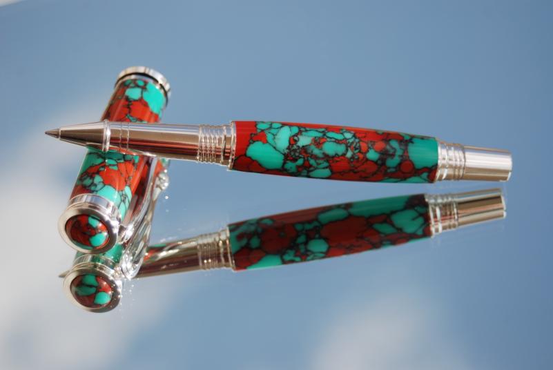

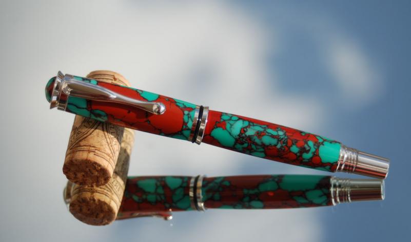

Finished this morning with second attempt at custom finial. Carbide cutter is still impressing me...Shout out to Richard at R&B Crafts who sent perfect blanks!
Great job! I really like the Jr. Retro. And the custom finial cap looks awesome. Looks like a marble was embedded in the cap. IMHO, they should never even include the stock finial cap with this kit. It just doesn't look right without a matching finial cap.
