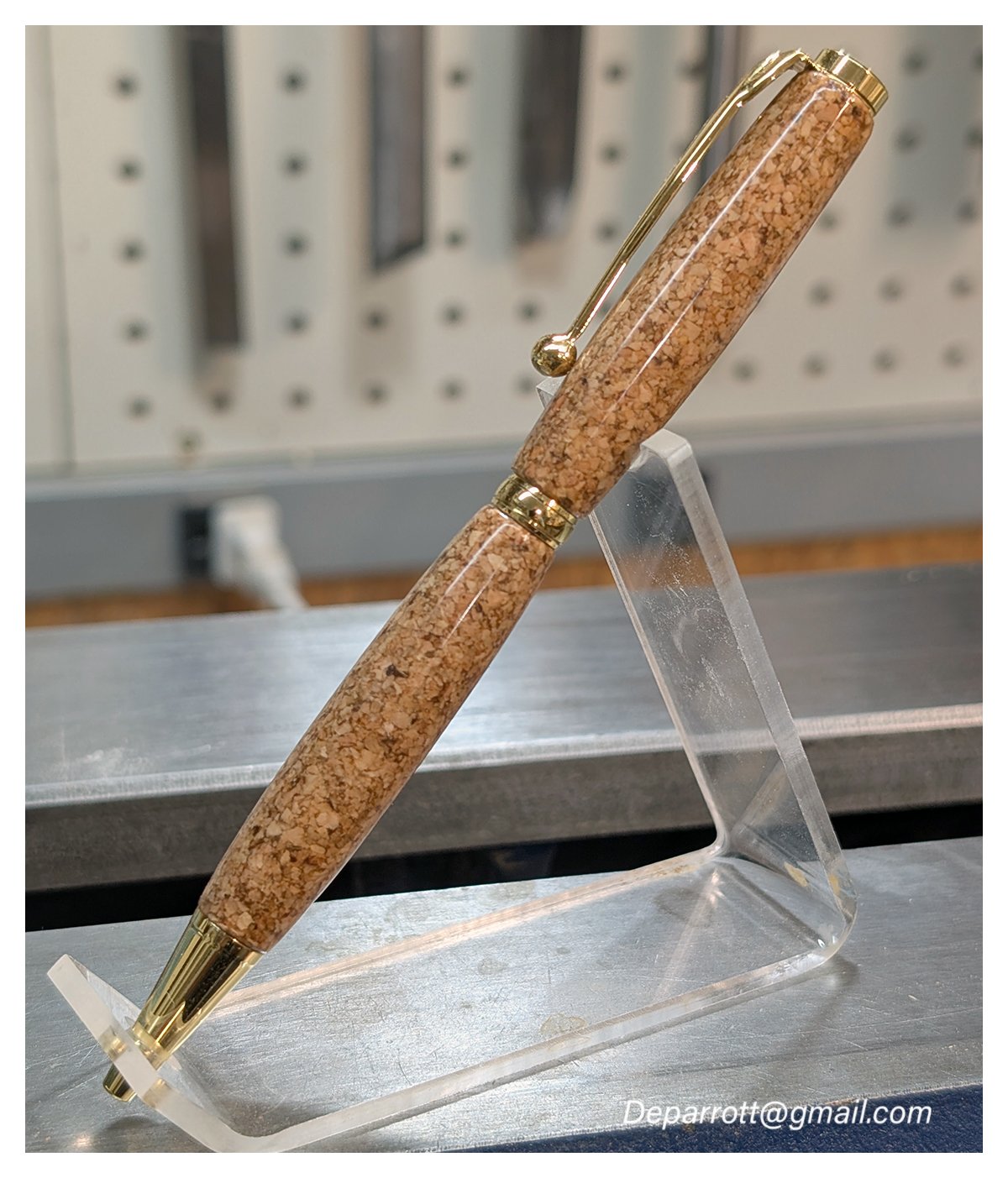

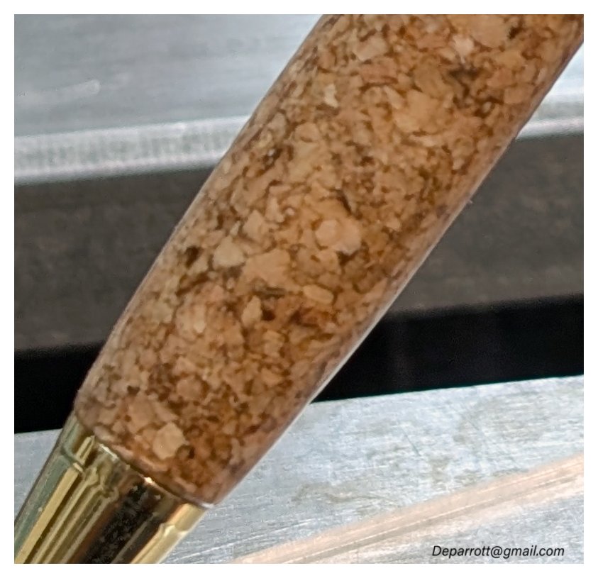

A local penturner recently asked me if cork could be turned on a lathe. I'd never even considered it but that one question lit a spark. Suddenly, my brain was buzzing, and before I knew it, I was "borrowing" one of my wife's cork trivets and heading to the shop.
Naturally, I asked AI if you could stabilize cork with Cactus Juice. It confidently said no and then followed up with a bunch of technical stuff that sounded like it was meant for a chemistry textbook. I gave it a try anyway. (Spoiler: it didn't work.) But hey, I had to try. It's in my DNA.
The trivet was only 3/8" thick, but I made it work. I saturated the cork with thin CA glue and let it dry, then glued 2 layers together with medium CA. Most of the shaping was done with sandpaper, starting at 60 grit and working my way up like a determined woodpecker.
Now I'm thinking about giving it another go, this time with turning tools, just to see if I can push it a little further. Hope you enjoy the experiment!

Quite well done, Dale. I do believe the finish you achieved on the cork is unparalleled. You would make any woodpecker jealous. 😆
I would consider a rotary tool, perhaps a small Dremel would do a good job. It could be a similar operation to grinding pneumatic shafts and pistons.
A few years ago George Valentine @robutacion turned down a blank made of polystyrene ( I believe ) using a flap disc.

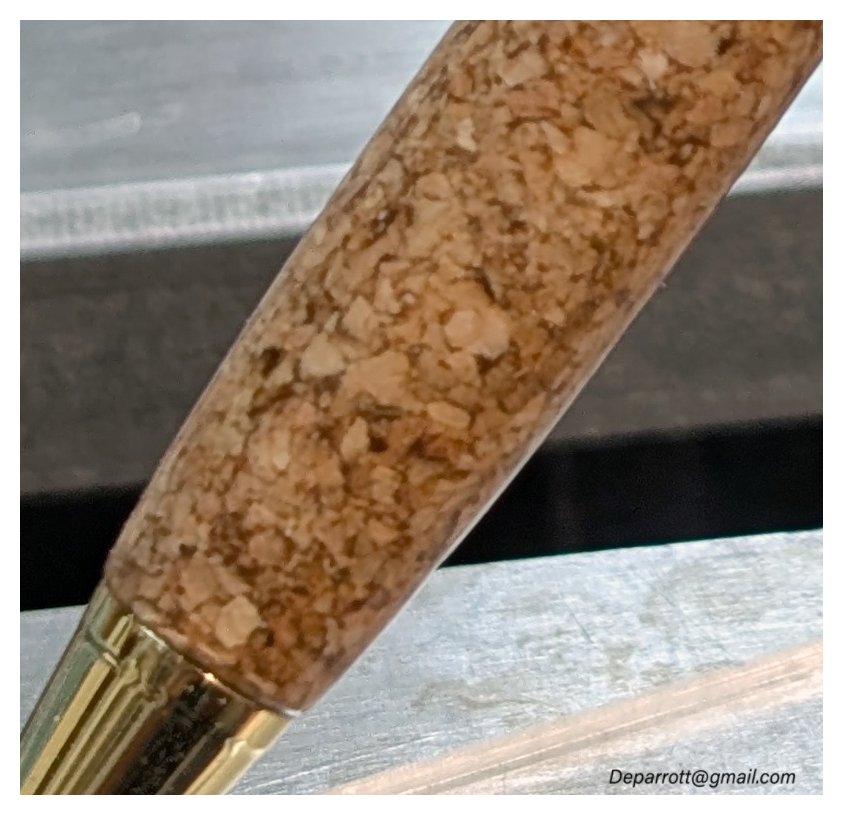

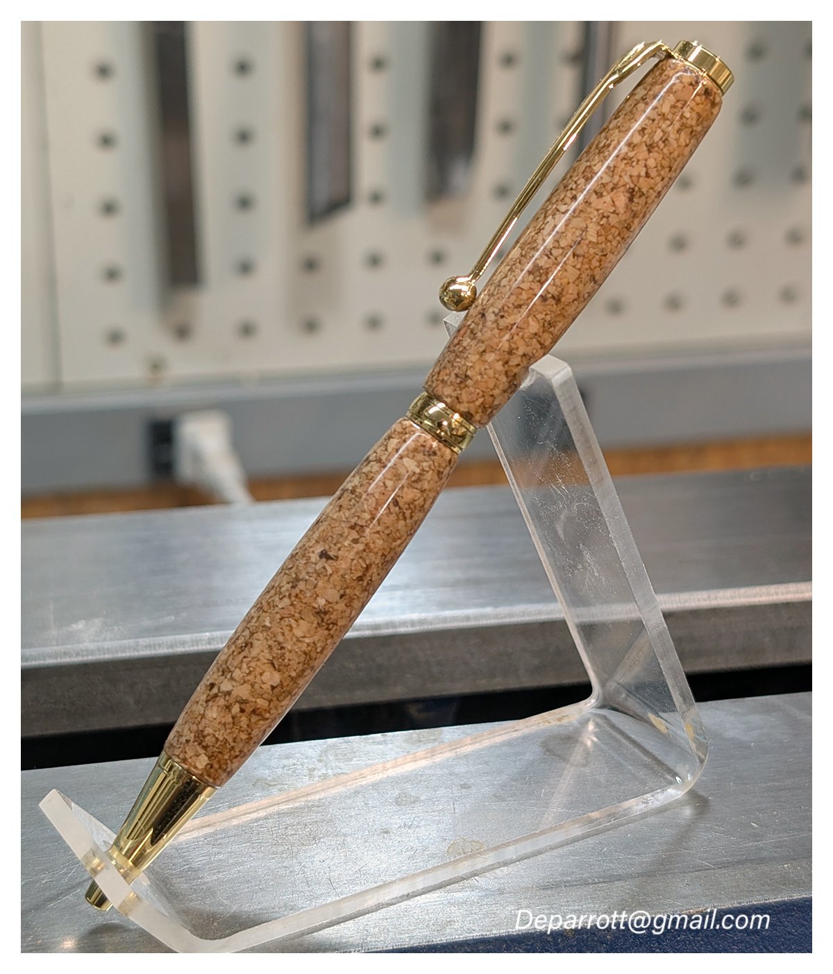

Dale,
Can you tell us about how you saturated the cork with CA? I assume thin CA. How did you get the CA into the middle of the cork, and did you use an accelerator to cure it?
I saturated both sides of a 4.5" X 3/4" piece of 3/8" cork with thin CA. Sanded one side and cut it in half. Glued the sanded sides together with medium CA and clamped tightly in a vice to remove the glue line. Drilled and used medium CA to hold the tube. Most of the shaping was done on my disk sander. Hope this helps.

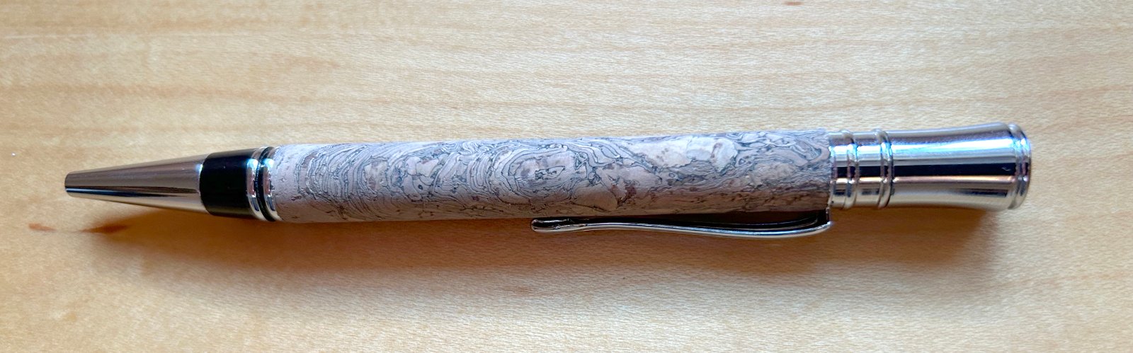

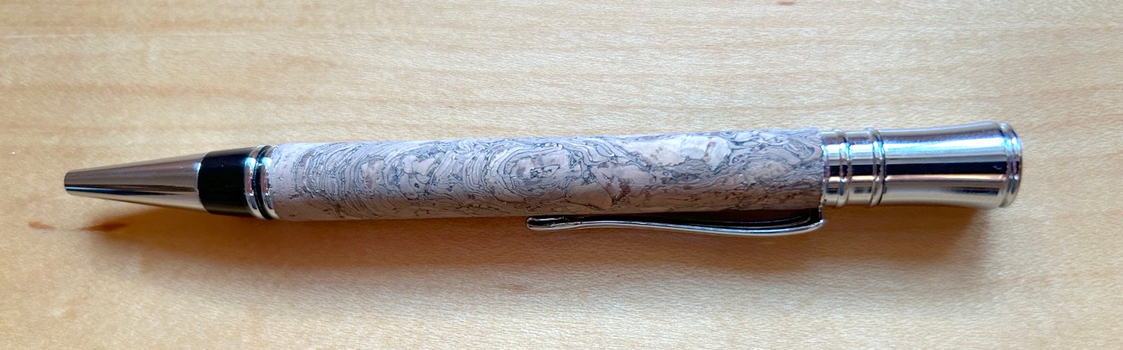

Anyone ever work with cork oak? Maybe this is what they make the corks from? I made a couple of these and left them unfinished; they're supposed to develop a patina with use--like the old fishing poles. I gave two to my kids and told them to report back. (No news so far)
