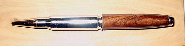

cozee Member Joined Oct 4, 2005 Messages 1,831 Location Sadorus, IL. Nov 7, 2006 #1 I've got casing pen fever. Nickle plated, Copper kit from Woodturningz, and CA finished Morado. I noticed by the pic I need to do a little fine tuning!!
Skye Member Joined Jan 3, 2006 Messages 3,487 Location Rock Hill, SC Nov 7, 2006 #2 Nice one, I like the taper of the upper half. You doing the 7mm hole in the primer end or drilling it all the way out?
cozee Member Joined Oct 4, 2005 Messages 1,831 Location Sadorus, IL. Nov 7, 2006 #3 I drill the primer end at 7mm so as to help keep the alignment. I size the tube on the slug end with some scrap wood turned to fit.
