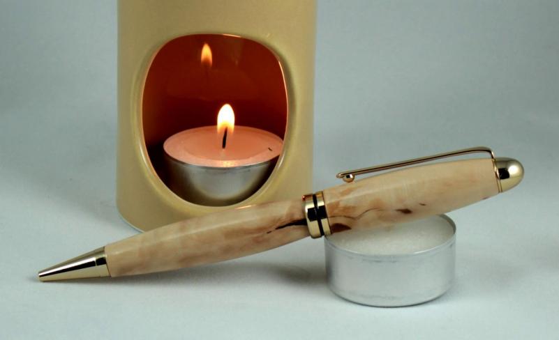

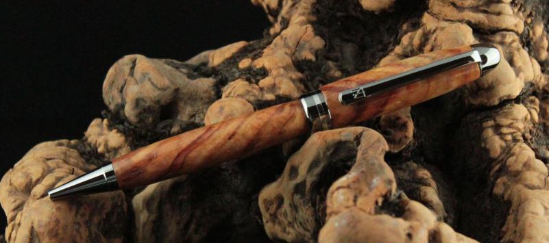

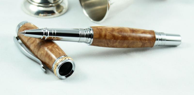

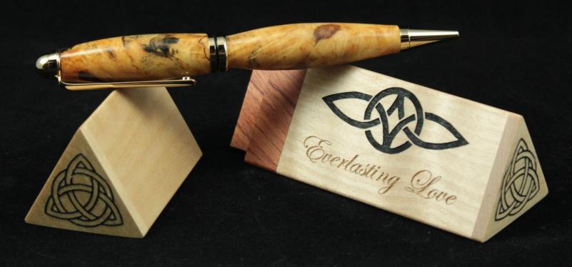

I rarely take the opportunity to post some of my stuff, but since I have a few photos of my work close at hand, here they are for your C&C. Feel free to offer suggestions on how to make things better, either the pens themselves or the photography.
This one was given to a dear friend. It's a Euro in black Ti... not positive on the blank, but I believe it came out of the Maple box. The background is one of many chunks of Manzanita Burl I have lying around.
(See Photo #1)
This one was also given to a good friend. Another Euro in gold... it's Maple, but the blank turned out so white I initially thought it was a dark piece of Holly.
(See Photo #2)
I still have this one (and may just keep it for my own use). It's a Triton rollerball with a Yellow Box burl blank. The background is a couple of silver shot cups (I spent quite a while polishing the tarnish off of them before use).
(See Photo #3)
This one recently sold. Yet another Euro in gold (they're so easy to make!), with a Maple blank. I stabilized the snot out of this one with thin CA throughout the turning, so I think the yellow color comes from internal burning... I like the outcome, so I may try that method again rather than throwing it in the vacuum stabilization pot. The case is Maple with a Rosewood centerband. The client's wife is a fan of Celtic stuff, so I engraved a Celtic knot in either end and a triskel on all three faces (both in black)... the script "Everlasting Love" is done in gold underneath each triskel.
(See Photo #4)

I realize the black background tends to lose the edges of the pen... it was a quick photoshoot, so I used what was set up at the time. It looks like I did a poor job at sizing the ends, but I promise it's just the black background reflecting off of the gold kit.

Nice to see you posting some of this great work here as well and sharing with a bigger audience of pen turners. Job well done all around. It is always good when the clients are enjoying your work and who knows what can become of it too. Thanks for showing.
That happens a lot. I've had to go look at my own pens sometimes
because the photo looks like they're turned down too far. But then
I take out the pen and look at it and realize they're turned down too far.
They all look to be pretty nicely done, the turning. The photo's are a little out of focus(or maybe I need to go visit the doctor again?)....could be the camera is trying to focus on the 'items' in the frame and getting confused? A small DOF(say something like f/45) will help get your focus lined-out.
Congrats on the sales, and keep them photo's coming!
Scott (might got sawdust in my eye) B
Scott,
Because I was at work when I posted those, the images were pulled from my camera, cropped, uploaded to Facebook (and therefore resized), downloaded from Facebook, uploaded here (and evidently resized again), and probably decompressed/re-compressed several times along the way. I think the originals look much better, but there's always room for improvement.... but I'm happy to blame it on the sawdust :tongue:
