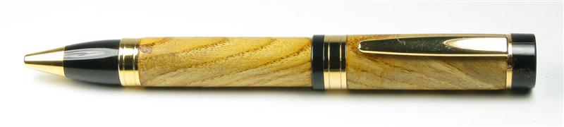

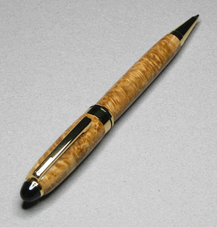

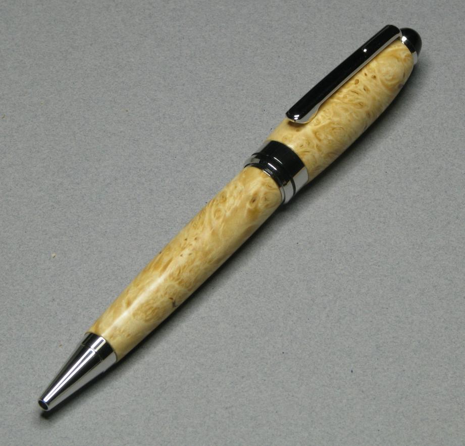

I'm only a beginner to Pen Turning, but photography is my biggest challenge. Tell me how I did.

Great selection of woods, nice finish, and the pictures look good, too.
To my taste, the upper barrel is a bit fat/proud on both of the pens, however.
Thanks for sharing and keep turning :-)

Hi Barry; Thanks for that critique. I'm taken with the fatness/proudness, rather than a straight line. Perhaps I'll try toning it down a little bit.
I haven't sold any pens yet, but I'm attempting to get an inventory together for a Craft show the end of Oct.
Nice work, and I'm with you, I think a straight bushing to bushing turn on these kits looks a little odd contrasted against the rounded caps. The photography is actually quite good, lighting is even and focus is pretty consistant throughout the depth of field. I would suggest that you try some pics with the pens parallel to the back of your camera instead of at an angle. Pics with one end significantly closer to the lens than the other can distort sizing and introduce other artifacts, as well as making it difficult to got both ends of the pen in sharp focus.
Nice looking pens. What kit and what wood? How do you finish? Beautiful wood.
Hi Paul; The kits are called Round Top European from www.penblanks.ca a family owned Canadian business. They host a small pen turner's forum "Penturner's Paradise" as well.
The pens are twists in Titanium Gold, stabilized, & dyed box elder burls. My finish is 3 or 4 coats of BLO/CA polished to 12,000 mm, and finished off with a coat of Renaissance wax/polish.
Hi jsk; You're not the 1st person to tell me that, and I know what you mean. I've taken a few that way, but they just have a blah look to them in my opinion.
