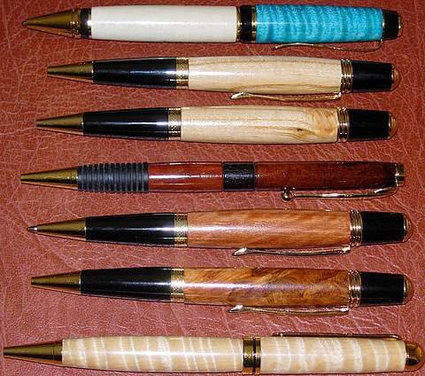

I've been trying to knock out enough pens for the upcoming local peach festival, but it's been slow-going. I did my first euro, but didn't quite get the thickness right, past the tenon. It looks good though. There are a couple of peach wood pens here and my 2nd class pen (at top).
Rob
BTW, does anyone know how to get that black stuff (from the pen wallet's) off? I thought it would be perfect, having a 48 pen wallet, to show off my pens, but the black sticks to lacquer finishes. I've moved to poly, but still need to clean about 4 of my pens off, before I can sell them.
Thanks,
Rob
If you want them to look right---you are going to have to tear them down---sand the finish off and redo them.
I know the price of blanks just went up[:D]

Nice job Rob..good luck with your festival. We have an apple festival here every year.On thre Euros..you could always forgo the center band and make your own..

I'm pretty new to this but I have been turning the euro's as practice pens. I turn the tenon for the cb first and I go very slow to get the fit right. After I have the fit right for the tenon, I leave the bushing on the tenon and turn the stepped bushing around backwards to hold it in place. It's helped me.
Hi Rob, nice set! I am guessing the two Sierras on the top are peach? If so, what are the other two blanks on the bottom Sierras? I'm liking them!

The bottom two sierras are:
top = Curly Eucalyptus
bottom = Maple Burl
I love that eucalyptus. I've done two pens from it and it turns very nicely, but the best wood I've ever turned, as far as fast and low chip-out was the peach.
Rob

Yup, it is. I turned the taper and then I sanded it too low, but it still worked.
I made another yesterday, out of mango and did the same thing with sanding. That's how I figured it out. I'll sand first, next time, then turn the tenon.
Rob
I tried to edit the starting post, but can't. The blue and white pens are "class pens". This is the 2nd one I did. I didn't mean that it was a 2nd-class pen, but my 2nd class-pen.[:I]
Rob
