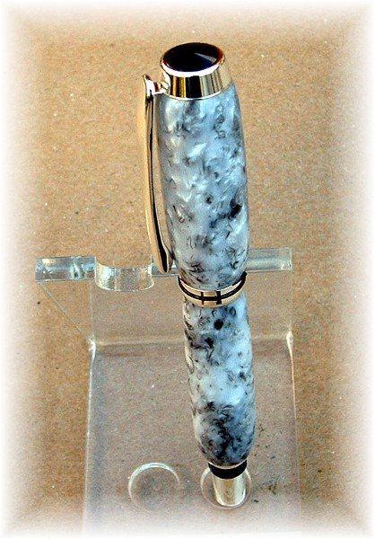

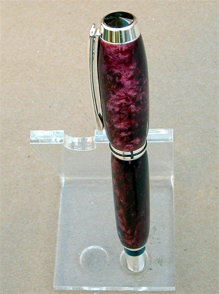

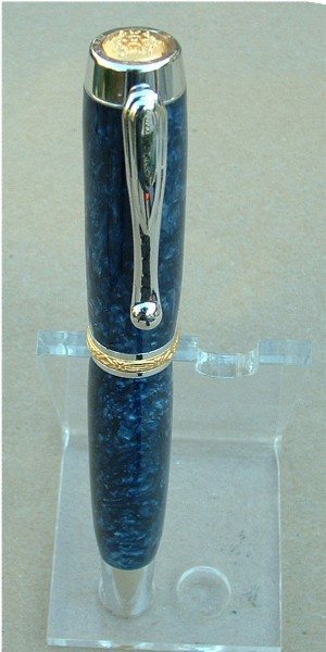

All of the pens I used PSI Euro-Rods they are great.
Statesman.
Barons

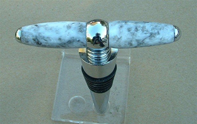

Wine Topper
Thanks for looking and as always comments welcome.
Alan

Alan, they look great. I really like the Statesman but I'm partial to the blue. I've never tried the Euro rod but I will have to in the near future. How does it turn? The wine stopper is sharp as well.

They turn real nice. A little more forgiven than some of the other resins but you still need a sharp tool with light touch. Although I tried one of the blanks with heavy cuts enough to cause blistering. Went back and was able to clean is up with just a light touch from the skew.

I wish I could tell you. All they have said is Italian Resin. It does smoke alot more then the acrylics when you get it hot. Shavings look like acrylic. For the larger pens you need to be dead center since the largest blank available is 3/4".

I turned "Alpine Ice" Euro rod this weekend-perfect fit pen.
MY rod is transparent between the white flakes. Even though the resin is a light blue, the tubes can EASILY be seen. So, if anyone is going to use this material-either paint tubes (white, silver, light blue, even a darker color blue) or hope your stick is more like Alan's.
BTW, this does NOT mean I don't like it - the pen is nice, but I painted the tubes (white) just in case and I am glad I did.

Both Alpine Ice and Tortise Shell are transparent and you need to color the tubes.
Tommy so far I have being very lucky I have been able to pick up 15" rods. The smallest is 14" the largest so far has been 16". I allow 1/4" over the tube for squaring the rods.

The length of the stick is a real case of "your mileage may vary".
The five sticks I got (ordered, did not get to pick out) vary by about 1.5 inches.
