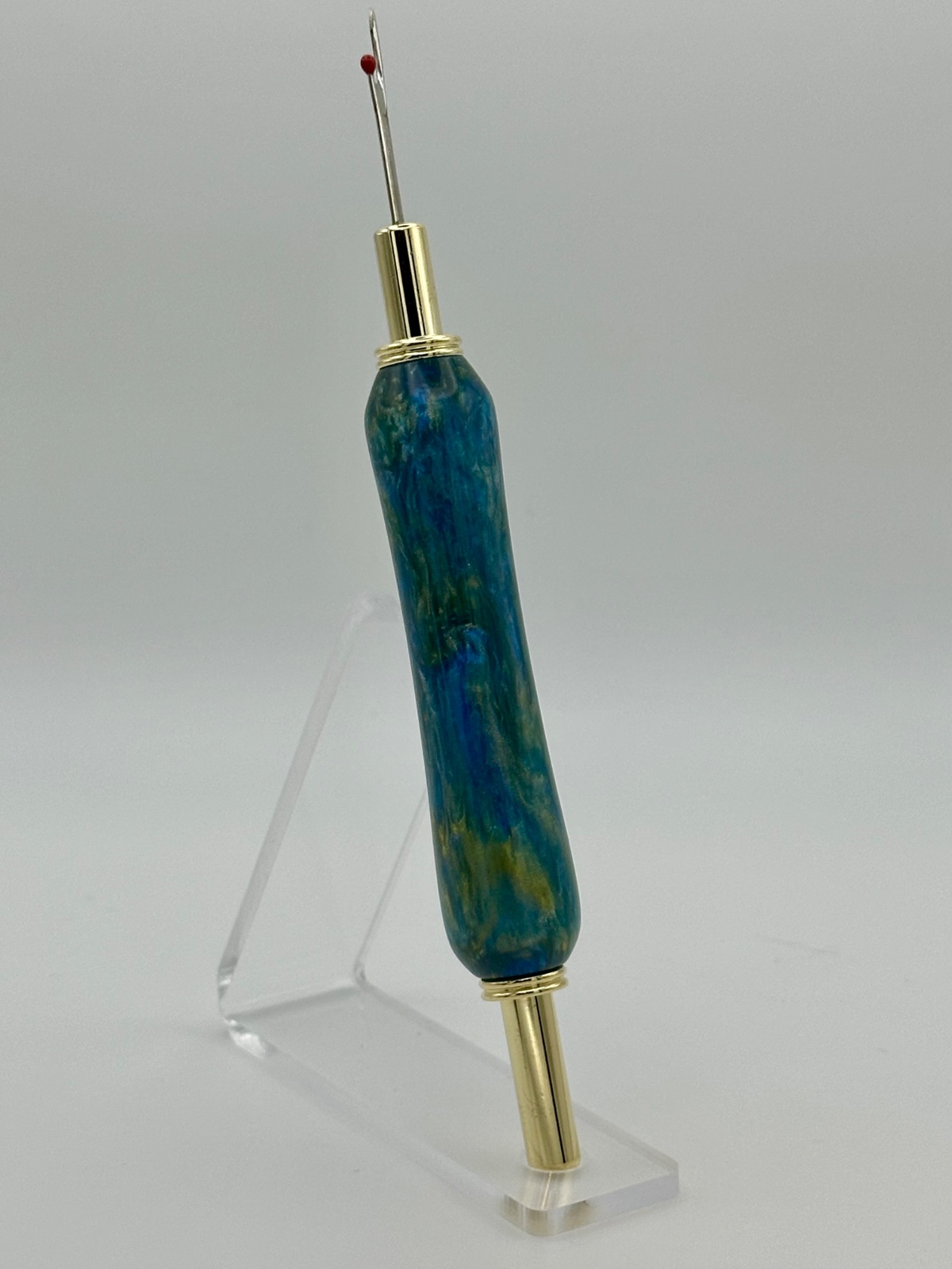

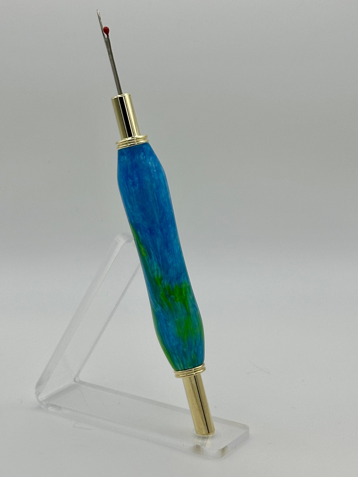

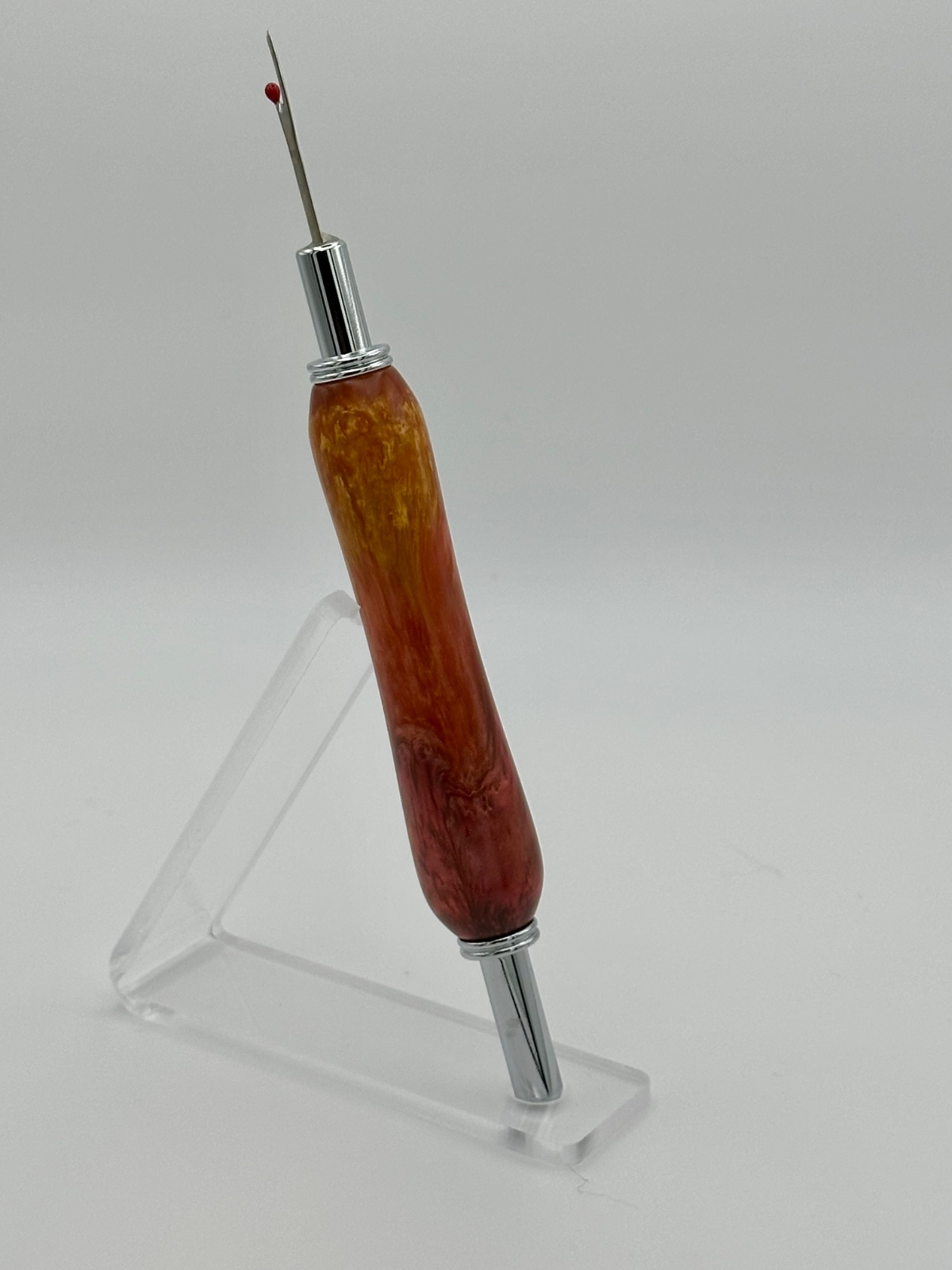

jschoolcraft Member Joined Nov 10, 2024 Messages 195 Location Virginia Sep 1, 2025 #1 Some double ended seam rippers from PSI. Alumilite clear slow resin and mica powder under 40psi for 12 hours and probably weeks before tubing Dry sand through 600 Micromesh wet sanded through all the grits Meguiars PlastX Renaissance wax
