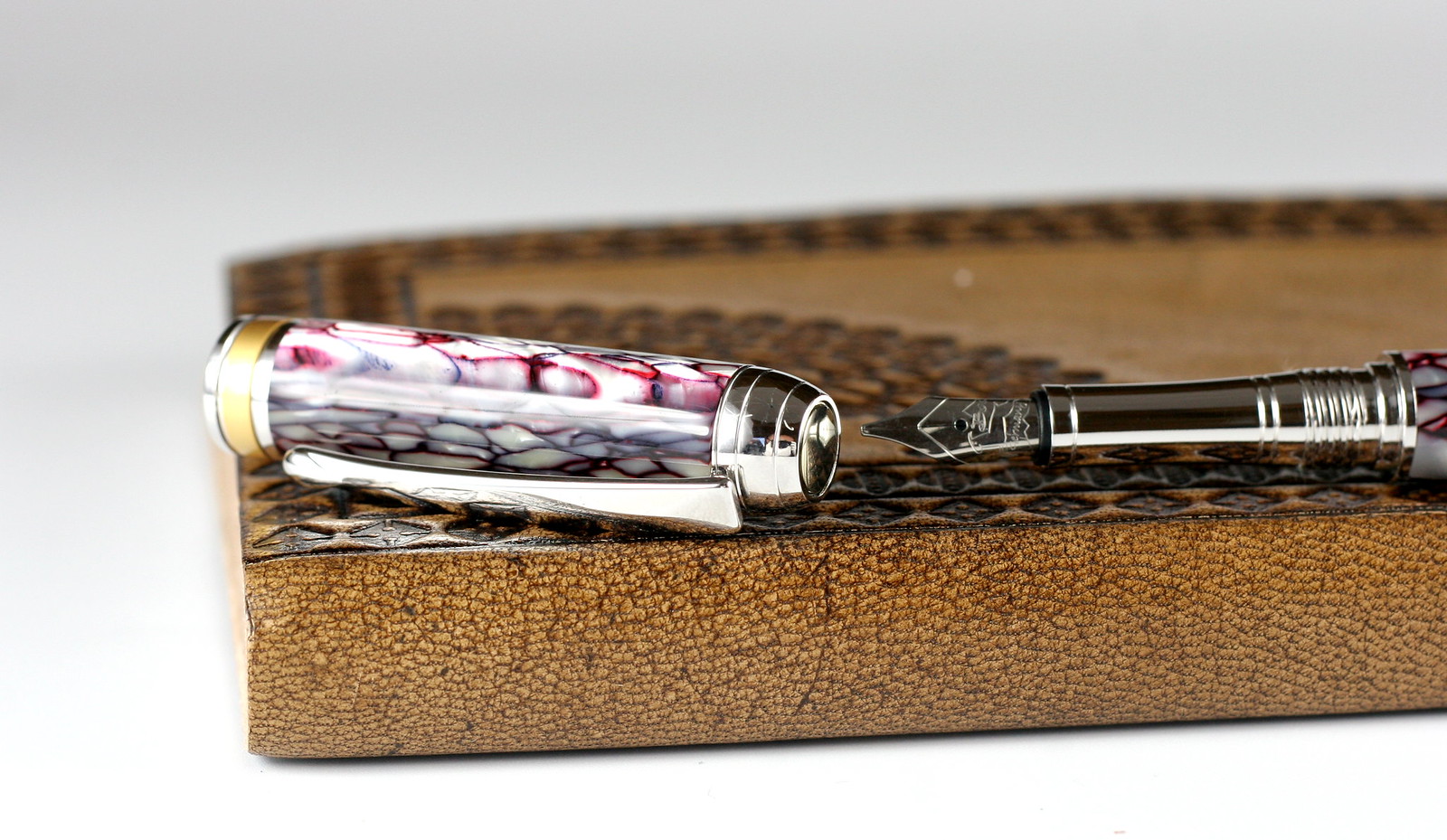

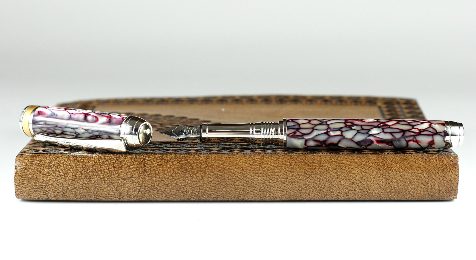

Because it is casein and does not like moisture, did you coat it with anything, like CA ?
Worked up through the grits, micromesh, then 20 coats of polish, 20 coats of an oil/wax finish and 20 coats wax - which should be enough to stop the odd splash affecting it too much.
When I sell them I put a large warning in with the info not to get it wet....
It does polish/finish up really nicely... just micromesh is enough to get a great finish.
