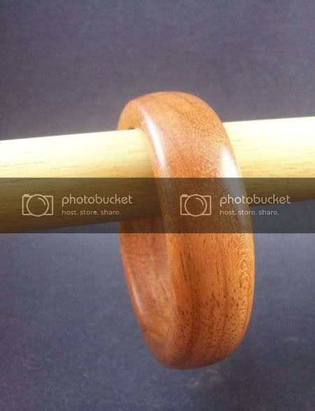

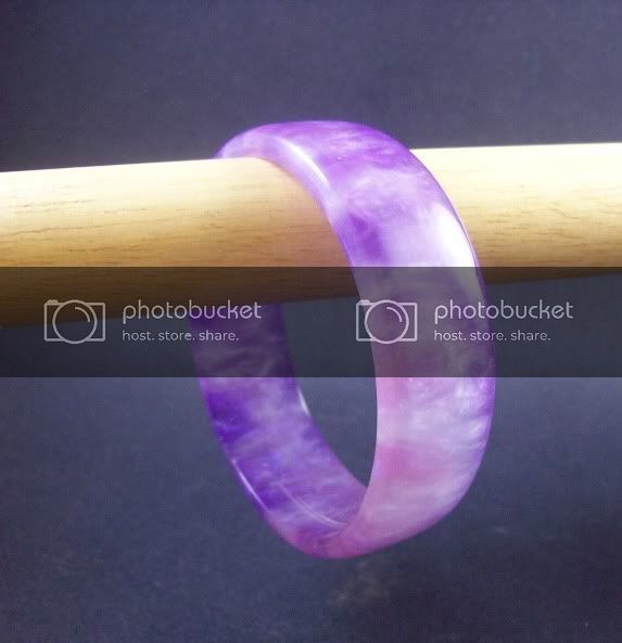

Here are a few. The first is a blank from Craftdiggity that came out great! polished up to 12000 MM.
Jatoba

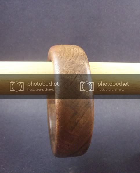

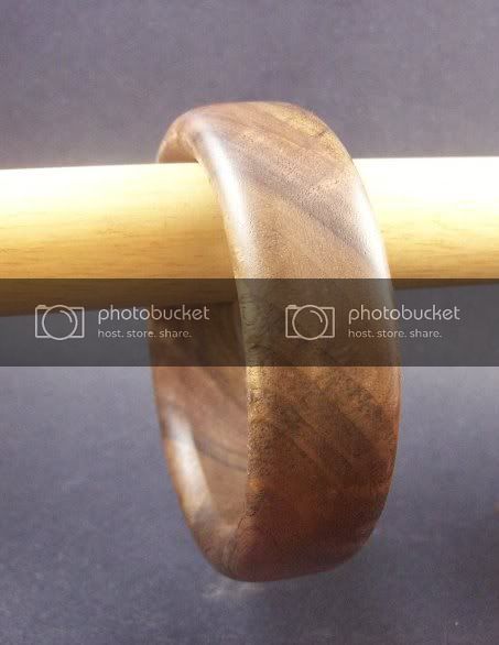

And a couple of Walnut
I agree the acrylic is stunning... Craftdiggity sells the blanks for a good price. I don't have a spindle sander so sanding the inside was a bit of a trick but well worth the time!
Lookin good, Peter. If you don't have a spindle sander, you can get a set that can be used in your drill press or on the lathe (if you have a jacob's chuck), at Harbor freight for pretty cheap, or you can turn a 2" dowel and use double sided tape to attach sandpaper. Then you can sand the insides a little quicker.

Kludge, your's are really nice... not sure which I like best, but leaning towards the woods more so than the acrylics... it looks plastic... LOL

I had nine of them at a craft show this last week. None sold. (Shrug) Still the wife likes them and had "acquired" the purple acrylic one. :)
