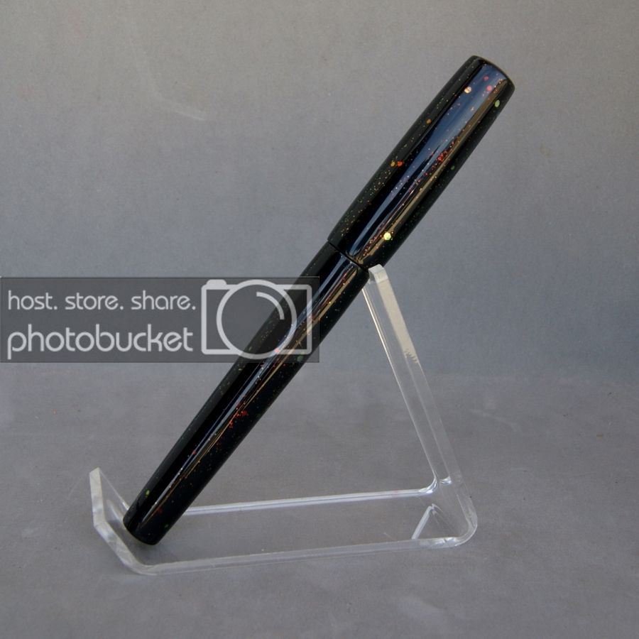

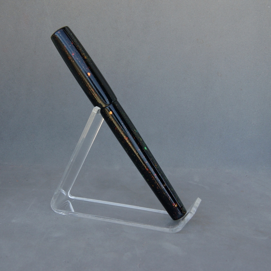

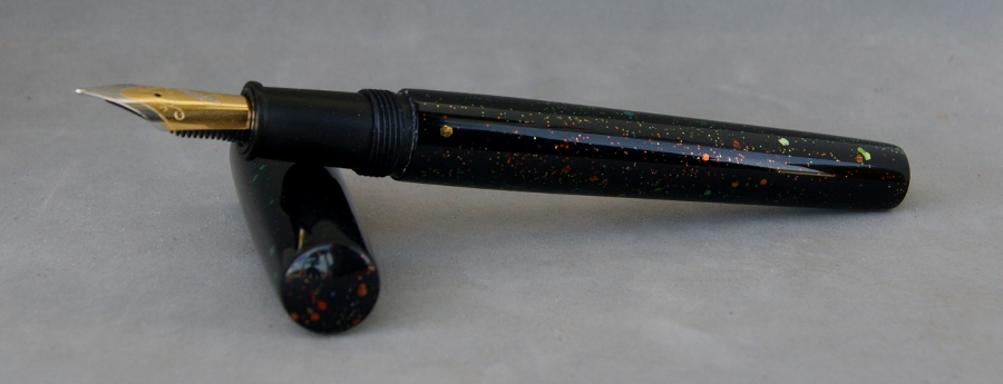

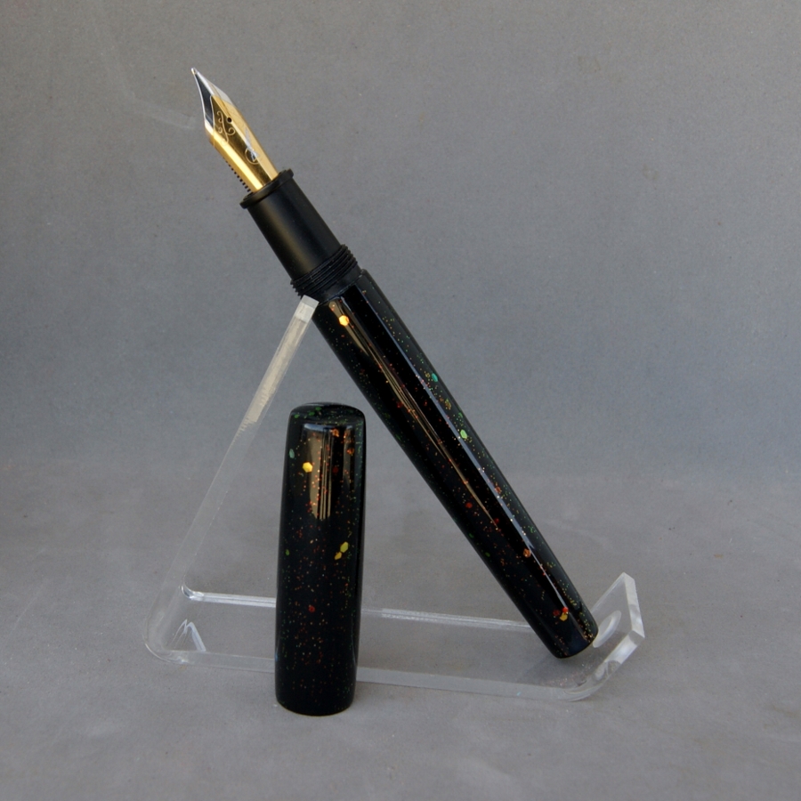

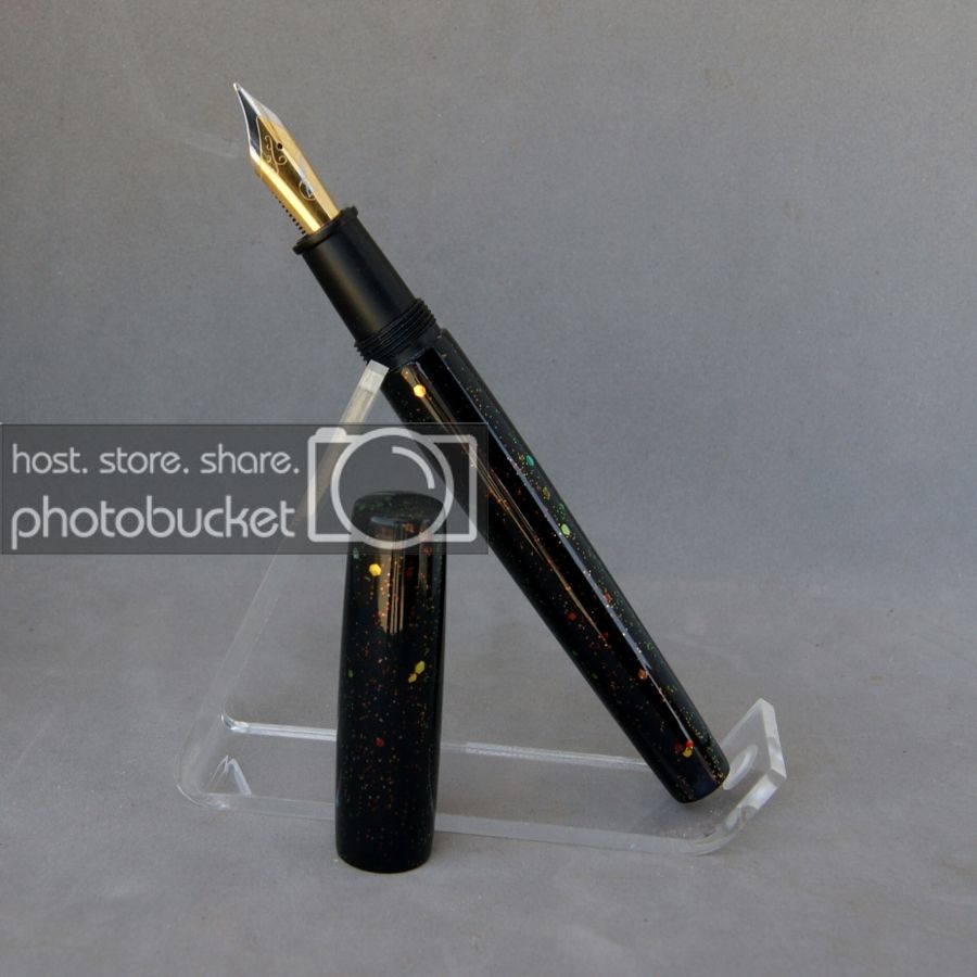

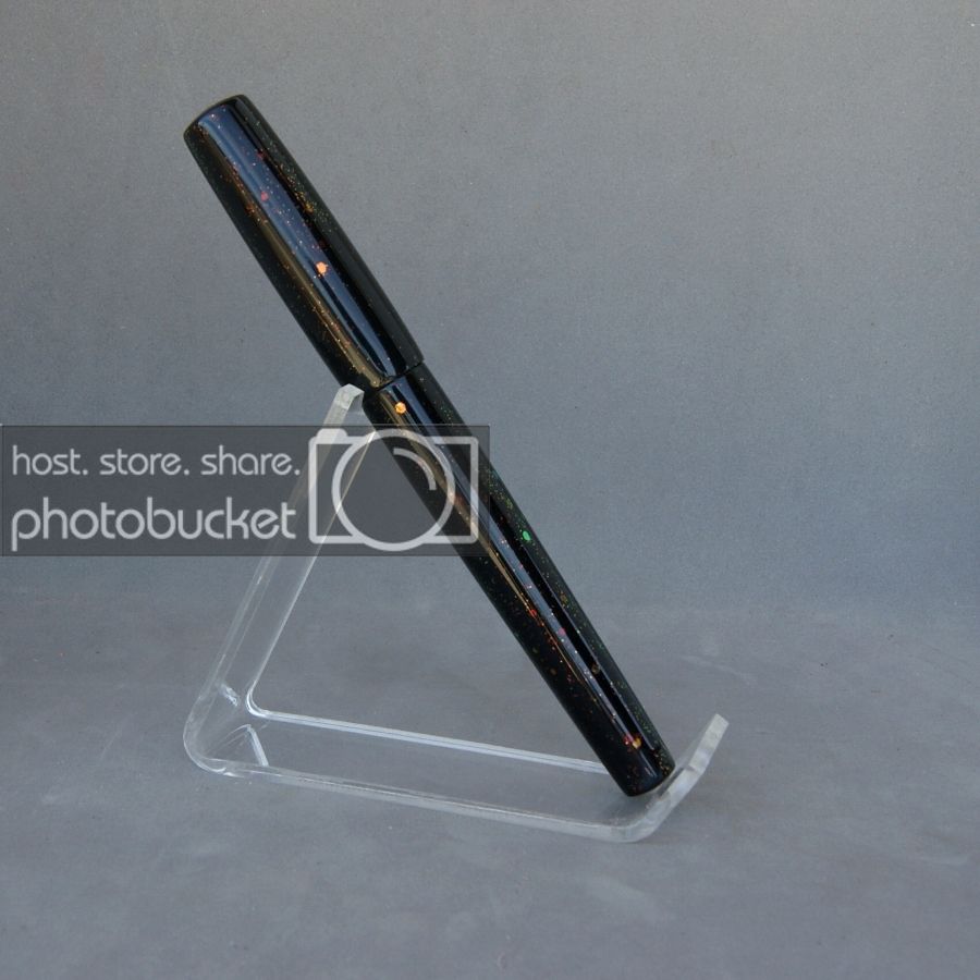

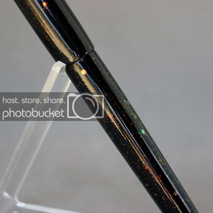

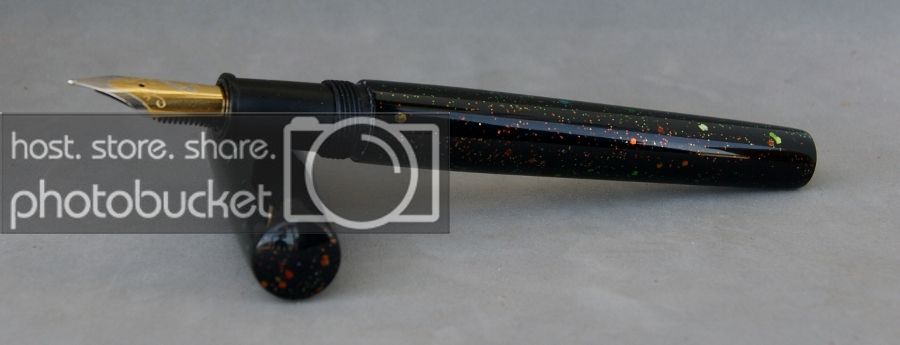

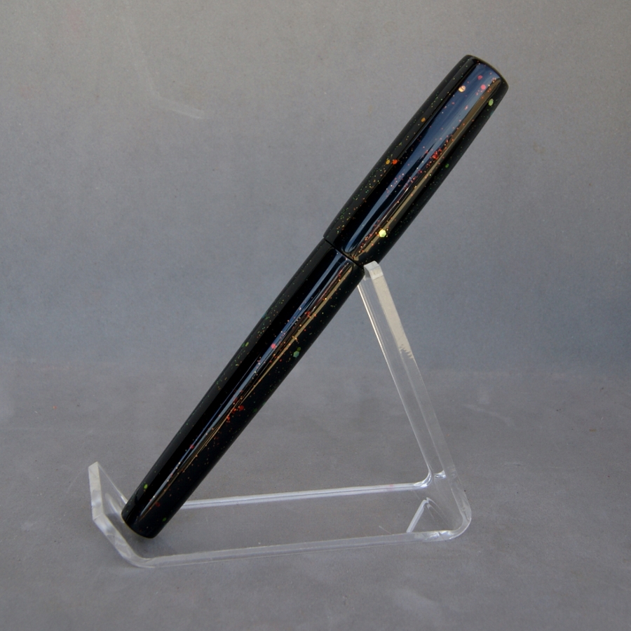

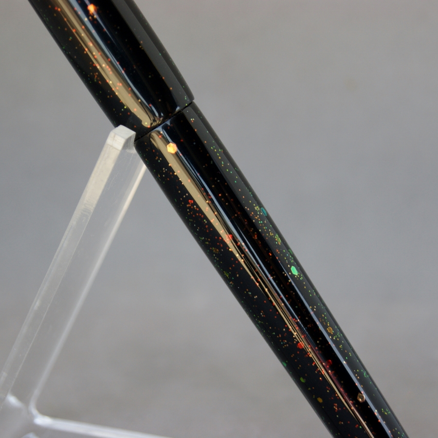

This was my submission in this years kitless contest.
This started out as a black ebonite fountain pen that I transformed into what you see now. I call the look "Solar Dust". I started with a black basecoat followed by various sized metal flake. Then I sprayed a couple thin coats of chameleon paint and finished the whole thing in automotive clear coat.
Dimensions:
Capped: 5 1/4" ~ 133mm
Cap: 2 1/8" ~ 54mm
Body: 3 3/8" ~ 86mm
Body + Nib: 5" ~ 127mm
Posted: 6" ~ 152mm
Nib & Ink:
#6 Two Tone Heritance in Medium
Cartridge/Converter/Eyedropper
DSC05499 (900x900).jpgDSC05503 (900x900).jpgDSC05504 (900x900).jpgDSC05511 (900x345).jpgDSC05500 (900x900).jpg
Thanks for looking!!

Very lovely pen, Jonathon !! Some of the larger metal flakes appear to be hexagonal .... I like that ! :smile:
Thanks! They're all hexagonal, it's just that some are .004" or smaller so you can't really tell. The larger ones I place by hand so I don't overcrowd any area.

Observation/Question: I notice that the section appears to have a mat finish. I see the barrel right next to it with a brilliant gloss shine. I am surprised no one has mentioned this yet. Great planning and design element! It really helps the pen body to catch the eye.
Is this just the bare ebonite or a sandblasted mat finish? I see no turning marks or finishing marks. (Of course!) It does not even seem to be burnished.
I do like this look against the slick painted finish. It appears to give a tactile surface to the section.

Great observation :wink:. I wanted the section to somewhat disappear. That and I just love the look and feel of matte ebonite. It is just bare ebonite. No sandblasting or burnishing.
