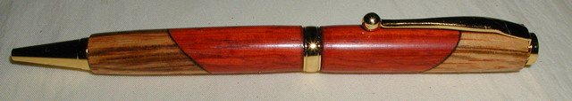

Heather, this is a comfort pen without the rubber thingie![:D]
