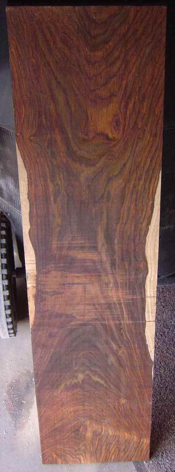

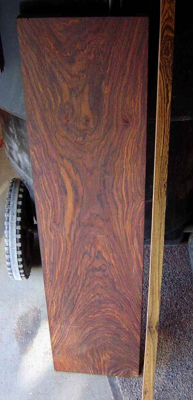

So there we were one day minding our own business in woodworkers supply and this jumped out and hit me.
front
back and a piece of Bocote I cut.
However, I dont think I will go back there anymore. I don't know alot about how others measure board feet for charges. But when a board measures 9x38 1/16 (mattering on how you do your tape and where) and you get charged for a board that is 10x39 (they say they round up). It bothers me a little. Hastur (Robert my brother) was with me, he purchased some Canary wood. They measured 5x72 and 5x73. He got charged 5.25x73 and 5.25x74? So I asked the manager on the phone. Do you always cut your boards 1/16th over so you can round up to the next inch? He gave me no respone.

Okay you mentioned about the bocote...but care introducing us to the piece that hit you? Looks like Cocobolo to me...and a pretty one at that!
That is considered the difference between rough sawn and finished. Seeing as how you have boards that are s4s, the measurements are very close to what they would have been roughsawn. Now if you are paying s4s price, you should not get rough measurement. if you are paying roughsawn price, you are paying for the correct size.
haha yeah its cocobolo.
John I am not sure if it was considered rough. Most of the wood in that area of the shop is cut, sanded (so they say) and planned. Even so if it measures 9 inches how do they justify going up 1 inch saying its rough?
