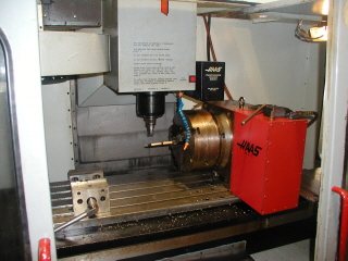

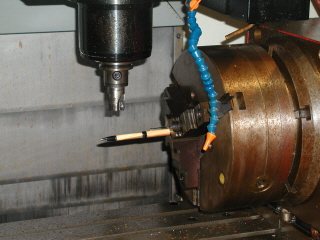

Ok I couldn't resist showing MY four axis set up[:D] Actually it is the one at work. (Think I need a smaller bit!)
Comes complete with coolant to put the fire out on the pen if I get too carried away.

Check out that Haas action. Paul, you'd be proud. I was actually working on a wood pen last night and was using my 4th axis machining center. It's long way from done, but i was nice to work on a pen for a change.
Originally posted by btboone
<br />Check out that Haas action. Paul, you'd be proud. I was actually working on a wood pen last night and was using my 4th axis machining center. It's long way from done, but i was nice to work on a pen for a change.
Yeah, one of these days I will get to do pens again. Haven't turned but about 6 in the last two years. Been at least 4 or 5 months since the last one[:(]. This machine is fun to play with doing real jobs in. I do get to use it to stencil my name on my vises though!
