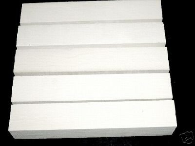

I bought some "SNOW WHITE HOLLY" from a dealer on ebay. See pic with black background. This is what showed up.The Pic with White background. Is this normal for "SNOW WHITE Holly"? Or does holly acutally get whiter than this ? I wanted to do a pink ivory and white holly but thought it would be whiter. Did I get HOSED ?
Dave
The seller probably changed the color balance is a photo shop program. There is one on ebay I have heard people talk about but no one has every posted his name. Hobbit house makes mention of someone but no name either.
If I'm right, I've bought from that vender and never had a problem with his items. In fact I bought some rose myrtle burl from them and let them know that it wasn't much of a burl (not wanting or expecting anything done) they cheerfully refunded my money with an apology. Just let them know your not happy, and they will take good care of you.
You say that your second picture has a white background, but all I see is grey. No offense intended, but how can we judge the color of the blanks if the color of the background is incorrect? The top picture does look overly white in my opinion. I have some 'snow white' blanks from AS, and they have just a tinge of yellow to them.
The Grey pic is on a white piece of notebook paper with not enough light I guess.It was mearly to show you the difference in real white and their show white. DFM hehehehe I think thats the issue ! they have too many dogs near by ![:D]

Lighting is obviously not optimum in your second pic, but the fact that the grain pattern is so prominent in a low-light situation would lead me to believe that your holly is not as nice as it could be. I've gotten really nice holly on more than one occasion from Ryan at Woodturningz...might give his a try. The blanks I've received from him are much closer to the first pic than the second.
"Snow white" is a subjective opinion when it comes to Holly. While it may be "white" when freshly machined or sanded, even the whitest of Holly ages to a light amber color that looks similar to that of old Ivory. Some Holly will have a slight greenish color before it is dried.
Photographing can be tricky. When using a black background, the thing that is being photographed will be bleached out and too light. When using white background you get the opposite with it being too dark. I think the camera gets confused about how dark or light it show be, looking at the background. I have had best luck using gray or some light color. Holly is a white wood compared to other woods but not exactly "snow white." Looking at your two photos, I would say your holly is probably ok.

The seller's picture was "touched up", and the holly has aged since then.

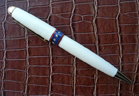

As far as sanding it without getting the pink ivory dust in the holly. I always turn to size with my trusty 1/2 inch skew and then before I sand or anything I blow off the blanks and then apply a good heavy coat of thin CA with a paper towel. This acts as a sanding sealer and allows you to sand without contaminating the lighter woods. You may need to apply another time or two as you sand through the grits. Just watch your sanding dust, as long as it's a white powder, you're sanding CA [:D]
Ain't the IAP just grand!!!
Originally posted by hrigg
<br />Nice looking pen. Did you make the CB, or did it come that way?
Harry, the stars centerband is a kit available from Ken Nelsen <u>www.kallenshaanwoods.com</u>
