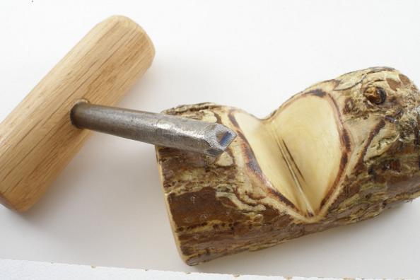

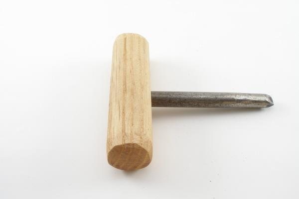

I made my own tool. It was simple and took a few minutes. And the size is easy to figure out. When it went in and turned the plastic piece, it was good. Here is a couple of shots of it.
Thank you all for opinions. It helped, specialy photos of tool. I have made something similar and it works. Now Im also not afraid to offer snap-on caps to customers, since some of you had good experiences with it. Thanks again
