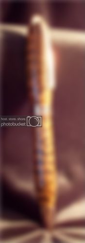

I made a snakewood pen as a gift for a friend of mine who absolutely LOVED the appearance of it, au natural.
Pardon the rudimentary photo, I'm getting with a REAL photographer to set up a picture solution... I'm one of those "necessary evil" kind of guys...
Anyway, should I tell him to expect this pen to crack? It's sanded down to 2K, then clay bar, then polished down to 12K MM, and I didn't notice any cracking.
I've seen posts where the pen cracked within a few days of the crafting process and others where it was on the order of a year before the crack occurred and, of course, there are pleanty of pens that never crack.
It is probably a good idea to warn your customer about the possibility; but I wouldn't make a big deal out of it because you might be one of the lucky ones who does not have a pen crack.
