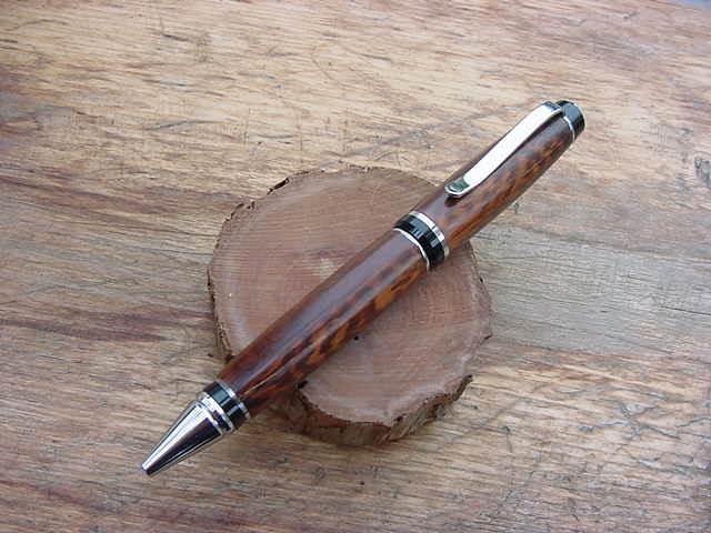

I have turned one pen in snakewood with good results. I turned this Baron on snakewood about 2 months ago and it still looks good, no cracks or splitting or shrinking. Maybe just had a little beginnings luck on this one. Who knows. I don't know how to post a picture here in reply so I will go and post a picture of it in Show Off Your Pen.
