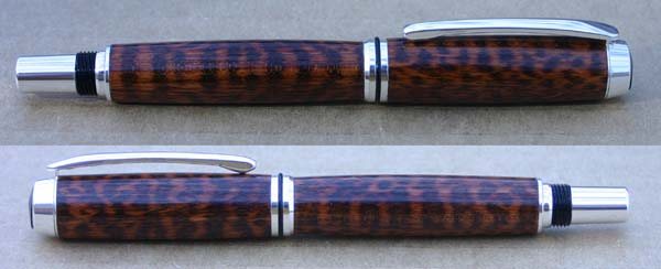

Here is a picture of a snakewood baron. It is my first snakewood pen. And to answer your next question, yes it cracked. It cracked while still on the mandrel. I drilled the blanks 6 weeks ago. I turned them to finished dimensions in three sessions over a three week period and sanded them one grit at a time over an entire weekend...waiting between grits...heat has been suggested as the cracking agent. After the final sanding I had dinner and went back to the pen in a couple of hours (no I did not eat for all that time ;) ) and the cap and barrel had both cracked lengthwise. I left the pen on the mandrel and put it on the shelf and in the next two weeks the cap had two more cracks and the barrel had one more. I sanded with 600 and saved the dust and made a CA/dust slurry and filled the cracks, scraped off the CA with a scraper, resanded and applied a CA finish. No other cracks have shown up and the pen had been finished for two weeks. It is still a nice pen...the plating is sterling silver and I will enjoy using it...the cracks are difficult to see, but they are there. Any and all comments welcome.

It is beautiful. It would be my favorite if it wasn't for the cracks (regardless of the price). I have one that I have repaired cracks on and we use it daily. I just can't sell any of them.

Thanks Serge: the blank for this pen came from http://www.westpennhardwoods.com but I'm sure BB at http://www.arizonasilhouette.com has snakewood also. West Penn Hardwoods was a vendor at the symnposium here in Texas back in October. I used epoxy for gluing the tubes.
Termite: Thanks for looking. The cracks are very thin, run the length of the cap and barrel sections. And, yes, you have to look closely to find them. They are well hidden in the pattern in the wood. Even with the cracks, the pen is a keeper, and I would sell it but I would tell the customer about the snakewood cracking and no guarantees on this one.
This one is going to the new Doctor in the family, who happens to be my son. He graduated from medical school last year just started his residency in general surgery in Houston. The plating is sterling silver.

Very nice, Don. Like many others, I've been waiting to turn mine (two half blanks) b/c of the cracking issue. I may just gut up and do it anyway. Yours is quite inspirational.

I have 4 more blanks. I think the next one I will turn the wood without gluing in the tubes and assemble the pen without gluing in the tubes. Maybe unglued tubes will allow then wood to move without cracking. I finally decided to do everything I had read about preventing cracking and if it cracked I would still have a nice pen. I will also try the method described by Steve Haine, aka Borg_B_Borg, in a recent post. Anything is worth a try. Thanks for looking and commenting.

don, would flexible CA maybe help here?
i too had the same problem you did a year ago, with a snakewood blank that had been sitting in a drawer for over a year...it still cracked...

I think someone had a snakewood pen crack with flexible CA. I don't think there is any escaping this problem. Enjoyed Saturday...THANKS!

Beautifull figure to that piece of snakewood. I think that is the only way to make a snakewood pen, let it crack, repair the cracks and your good to go. Very nice pen.

I have turned one snake wood, it cracked, I did much like you mentioned...it became an obsession....I think I worked harder on that one blank than any other I have ever turned. It sold quickly...but I was not sad to see it go, that was a free pen for the price I sold it for.....
It's a special wood and you have done it proud..very nice!

That's what I decided to do Anthony. Turn it, let it crack, repair the cracks and use or sell it. I have a buffalo horn baron that I made back in July and I carried it last week. I showed some pens to the bubbasville group Sat and the buffalo horn pen had cracked...big time...looks like that canyon out your way. Never had a deer horn pen crack, though.

I have tried boiling the snakewood blank for an hour the night before, putting the drill bits in the freezer, and everything else I could think of. The other fun thing is that it can develop crack(s) weeks or months later also!!! It is really to bad it is so beautiful.
