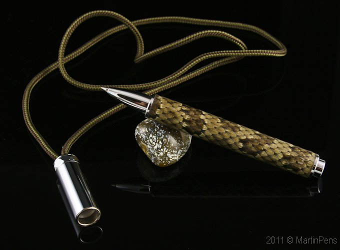

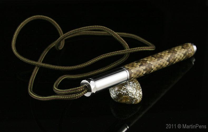

This was super simple guys and gals. Used a punch tool to disassemble the cap. Mounted the top cap piece into my PSI micro chuck. Drilled a hole (7/32). Bought a boot shoestring (bootstring?) and put it through the hole - tied a knot - put a spot of CA on the knot and cut the extra off and trimmed it close. It all pokes inside the cap piece. I left off the clip since it's not needed anymore and reassembled. Snakeskin blank is from Seamus7227. Thanks Seamus!
So nice to do something in 30 minutes during a rushed day and have it turn out.
p.s. Make sure you give the cap time to de-gas if you use CA on the knot. This will be a popular alteration for sure.

Very cool idea. As a suggestion, hit the Army Surplus store & get some parachute cord. It is a great olive drab green and the stitching is tighter than the bootlace. Plus you can melt the ends of the cord rather than tie them.
But this is a great pen!
