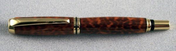

Thanks for looking. Keeping my fingers crossed that it won't crack.;)
Great looking pen.... I have three pieces of snakewood that are stunning... just waiting for the time to do them...
Please let us know how it holds up. Also did you do anything different to try to keep it from splitting...
Suggestions we have seen range from silicone caulk for gluing the tubes to sanding the inside of the tube so the fitting are a slip fit and need to be glued in place.... all to them to eliminate pressure on the blank when putting it together.... What did you do.. HHMMMM ????

Girz and others,
I dissassembeled the snakewood and fixed the cap portion. The body of the pen never cracked. I think what we all talked about before is that the cap liekly cracked from the pressfit pressure of the screw cap etc. Anyway, I filled the cracks with ca and refinished. Unfortunately I had some issues with the ca frosting over a bit when I tried to san it into the cracks. The finish came out decent, but it was more of a test. That was about 2 weeks ago, still no cracking on the cap this time.

Should have crossed my toes too.[xx(]
Two hairline cracks have appeared right around the nib.
I believe pushing in the coupler in the bottom barrel did it.
Things I'll do next time: Use another glue besides gorilla glue and
sand or grind off the coupler so it doesn't have to be pushed in.
Ideally I wouldn't use tubes. (If anyone can tell me how to do that
I'd love to give it a try)
Thanks
Don't feel bad Bryan, if you would have done the things you mentioned above, it still would have cracked. But it still is the best looking cracked pen you have. [:)]

Hi Bryan
I have 1,000 - 1,500 yr old wild Greek olive wood - that will not do as it is told!!
Try this make as normal - keep your temperature down - fingures on will you sand - no finish - no sealers - leave for two days to settle - then any cracks that have appeared thin CA with the fine sandings thrown over pat in, leave 12 hours, back to the lathe, repeat process until no cracks!!
Let me know
Mik
