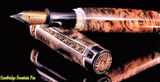

Toyotaman makes excellent point regarding BLO (boiled lindseed oil). While there a several UTube and IAP techniques that recomment it's use, I've found it is the fastest and best way to destroy what could have been a superior finish for all the reasons Toy... enumerates. I too have remade my share of expensive pens that turned white. Of course they don't turn white until after they are assembled.
