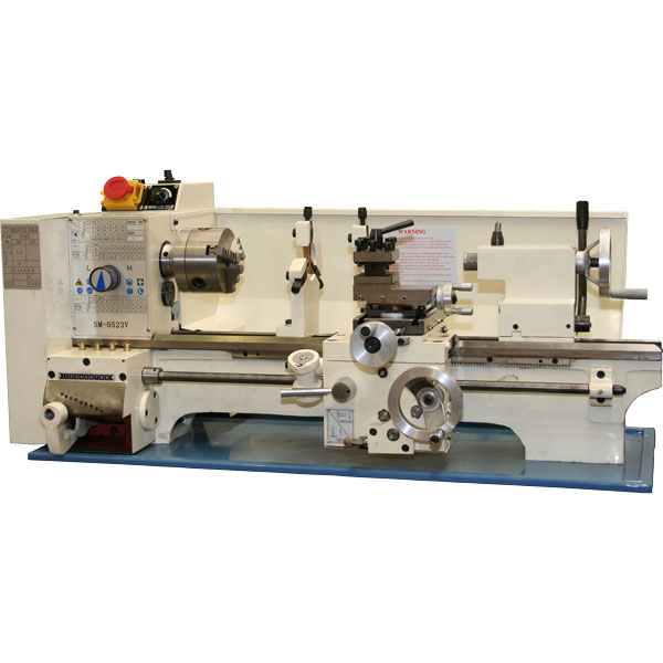

Picking this lathe up next Wednesday:smile:
Fred that's a very nice little toy, could you bright me up with 7x14, 8x16, 9x20 what is the meaning of those numbers, Thanks
Serge, the 7 is the swing over the bed, ie the maximum diameter you can turn, the 14 is the distance between centres (or should I say centers?:rolleyes:).
So the 9x20 can swing 9" and has 20" between centres. It is a much more substantial (and more powerful) lathe than the 7x14. To illustrate, the 7x14 weighs 45 kg the 9x20 weighs 135kg! I would say that the 7x14 would do everything I am planning to do with it, however as I have found in the past, once you buy a tool your expectations of it increase as you learn what it can do.
