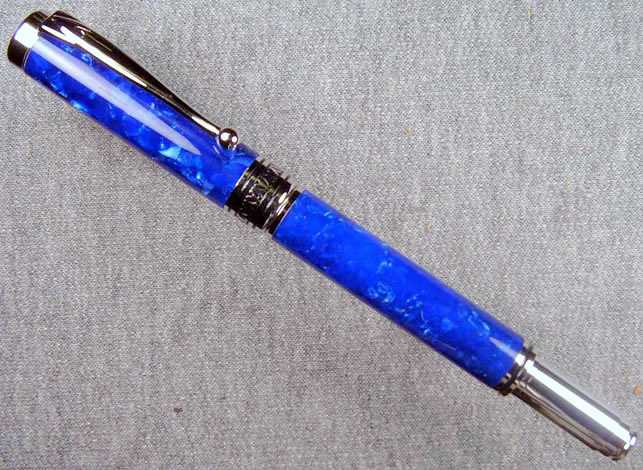

PSI and CSUSA both make thinner FPs. Here's a Platinum one from CSUSA.
<b>Image Insert:</b><br />
<br />
The cap is only slightly larger than the body barrel and bot use a 10mm tube. They also make them with both barrels being turned the same diameter, but I think they are only available in gold platings. Both styles are smaller than the Baron.
Wow, if that's a 10mm barrel you're probably going to have to paint the tubes. I cant imagine them not showing through.

Bill, I understood this. Both and CSUSA Americana and those similar to it (all snapcaps) are smaller in diameter than the Baron and up. In fact, all of the snapcap FPs I've seen are smaller in diameter. IIRC correctly, the smallest screwcap FPs have the diameter about that of the Euros (or larger).
The snap cap is a great choice. The upper cap is about 12.5mm and the body 11.5mm so there is plenty of wood on it. Much more than a slimline done b2b. I do highly recomend the "nib adjuster tool" CSUSA sells. You will not like the fit of the cap without it.
The pen is a little long (IMHO) but not too heavy, not too thick and fit & finish is very good. The Rho. kit is nice because all the hardware is polished where the gold kits have black finish & gold
