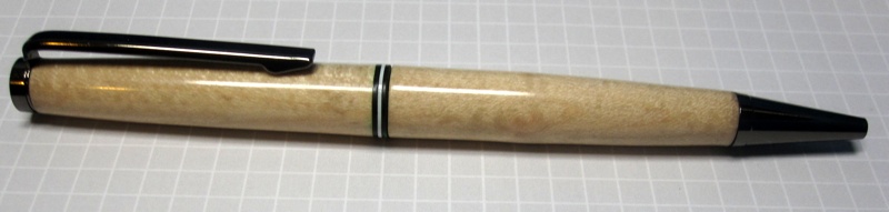

First attempt. I think this is Maple. The band is a piece of credit card between two guitar picks.

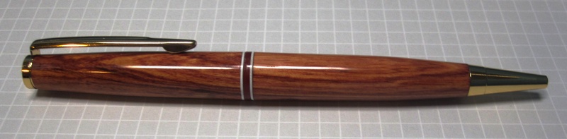

Second attempt, a gift for my son's teacher. Tulipwood. The band is a Doctor Pepper lid between two pieces of credit card.
These were both turned with no center bushing, turning the band along with the barrels. This allows you to get a "comfort pen" shape without switching to a different kit. And it's actually easier than doing a Slimline the normal way...
