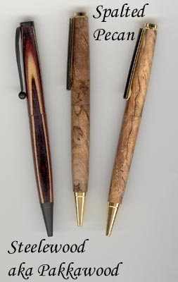

Ryan, if you take the centerband out of a slimlline and put the pen back together, you will still have a functional pen. It will be a bit shorter, that is all.
The reason I make the top tube about 3/16" longer when I don't use the factory centerband is for looks. Look in my pic album, there are some pens I made that way.

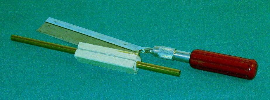

For longer barrels I buy 10" long 7 mm brass tubes from Woodturningz. I cut them to size. Makes a stronger pen.
Cutting tubes is easier if you make a jig. Cut a blank out of soft wood, like pine. Drill your hole as usual. Then cut lengthwise so one side of the blank will be slit down to the hole.
This little jig allows you to put the tube inside, and clamp it in a vise with the slit on top. I use a razor saw from a hobby shop to cut the brass tube. The tube retains its round shape this way.

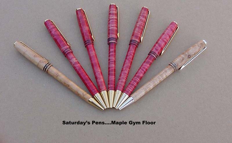

I make the bottom longer when I don't use a CB. I get tubes for the euro and use the longer tube on the bottom of thje slimline. The transmission must be pressed in a little furhter. Sometimes I have made the top too short with a regular length bottom and the pen did not work. The longer bottom is pleasing to my eye, but, hey Fred, Your pens look great, so don't change what you do. It would be a boring place to hang if we all did the same thing. Diversity is in the house!

If the ends that meet are squared precisely with the tubes, the blanks can be butted against each other on the lathe and the diameters where they meet can be exactly the same and the seam is almost invisible. These aren't perfect, but are pretty darn close.

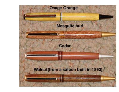

Nice looking pens, Don. I personally prefer a separation material whether it be pick guard or knife separation material. It is awfully hard to make a seamless transition between the top and bottom. A fine black line, or whatever color you like, makes it look less like a mistake to me when the grain isn't perfectly aligned.

I am personally not a fan of the wasp waist pen, or the corset style. Lots of them are made and look nice and this is just a perosnal taste matter with me. As far as the CB or no CB, I have come to like some kind of CB as a transition between the two halves as Jum mentioned. Again, just a matter of personal taste. I don't see many of these modified slimlines sans CB. I put these up just to point out that a "no CB" look is possible. It doesn't have to look like a mistake. The transition between the two halves can be made to look like it was planned if that is the look one wants. I have become a real fan of picguard and other thin plastics sheets. Credit cards make a nice thin separation.
thanks for the possitive comments on the CB-less pens. I think those were the last ones I've made. I've become a real fan of Russ' takeoff on the KC twist, the russline and have tweaked it a little to make it a little more me. I make the bottom a little longer and recess the finial and clip a little. I also like Russ' fatline and do the same with it. Thanks Russ for the instructions. Here's another sample.

Thanks again Jim. There is no end to what can be done with the slimline.....limited only by one's imagination. It is a very versatile and forgiving kit.

Picguard is a plastic material of laminated colors that guitar makers use under the strings on the guitar to guard the guitar from the pic scratching it. Hence the word, picguard. Google pictguard or luthier supplies and you'll find some.

Here is a link to pickguard. Luthiers look at the surface color, but we use it for the edge pattern. I like the white/black/white, black/white/black, b/w/b/w/b, red/white/red/, yellow/white/yellow/, y?b/y and others similar. There are other sources. Searching on pickguard gives better results than picguard.

I have a few BOW slimlines without the stock CB in my album. I also cut new tubes from extra stock. Tried a tubing cutter first, but squished the ends too much and I had to ream them out a bit after that. May just be my technique. Use a razor saw now. I'll have to try that jig - I've been wrestling with them in the x-acto miter box.

Eddie, my little tube cutting jig actually holds the tube with just finger pressure! Use soft wood like pine. I hold the jig in my vise.
10" tubes are available in 7, 8, 10 mm, and 3/8" at this time.
