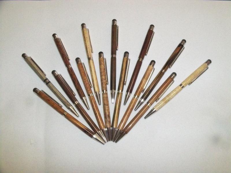

14 Slimline stylus/pens. Twelve are a part of a prepay order and two were extra for sales.

I found making 14 slimline pens to be a real drag and I cannot wait to work on something more creative!! The slimline stylus/pen has sold twice as fast as my other pens. It is frustrating to make pens I don't like and watch them sell before my other more intriguing products.
Don't tell my customers especially the return customers.
There are lots of ways to make a slimline pen more interesting. You can find lots of variations of slimline pens here. For example, you can remove the canter band which opens up lots of possibilities.
Here is another great resource! The Pen Pages
Also, combining the one piece Slim and the stylus makes a REALLY nice pen, and it does add an element of challenge. I'm still refining my process, and I did finally get tired of making one pieces after a long run.
I've made them without center bands, into desk pens, larger than normal for arthritis sufferers (the most rewarding), with designs, with inlay, with cholla, and a few other design varieties, but overall they are far from being my preferred kits. I am adding the stylus to some Cigar and Patrizio kits this week (hopefully).
I have already figured out the procedure.

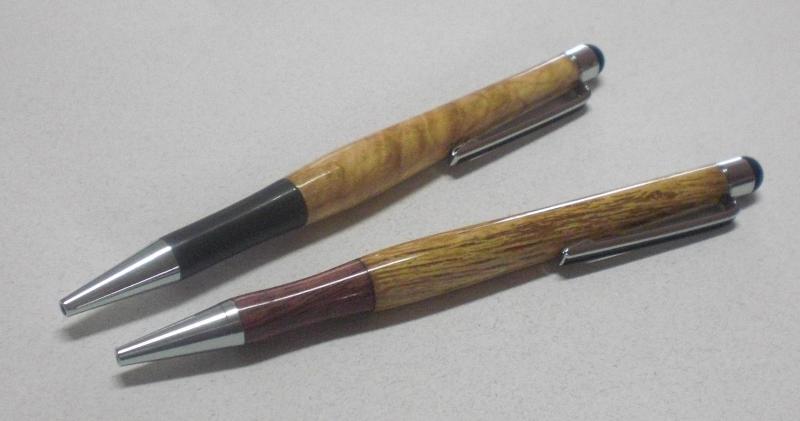

I didn't make the one piece slimline. The more I thought about it the more I realized I didn't want to twist on the tip. Instead I made the tip section just over an inch long from Purpleheart and the longer section of the body from an un-identified wood that is yellow and brown striped (REAL SOFT). I also didn't cut the traditional straight body. I will post a picture soon.
