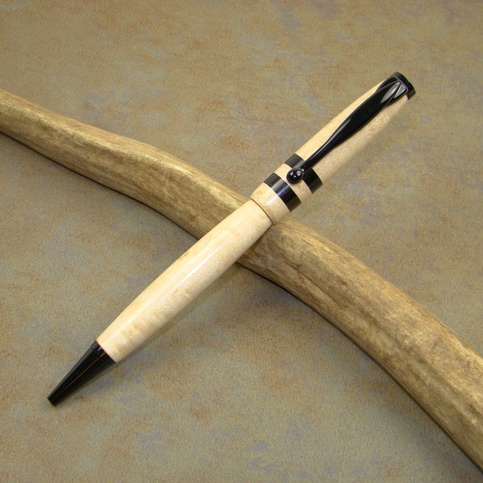

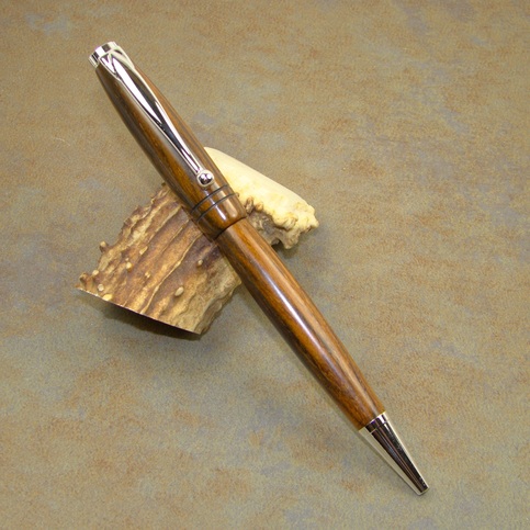

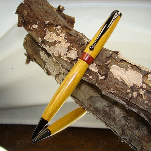

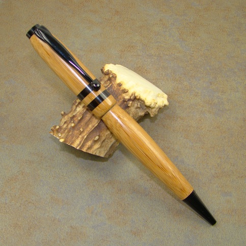

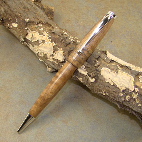

Really enjoying the modified slimline alternative to a designer or euro pen. Some of my recent creations:
Curly Pyinma - flashing bands
Bird's Eye Maple w/Ebony bands:
Cocobolo w/etched bands:
Carmelized Bamboo w/Ebony bands:
I actually use the regular slimline tube for the bottom barrel, just make the blank a bit longer so there is no tube for about 1/4" on the transmission end. Makes you a bit blind inserting the transmission but just go slow and check the depth frequently. Thanks for the feedback, all!
I've done that and forgot to reverse paint a couple times. If you look close enough you can see the brass part of the tranny. Lessons learned I suppose.
