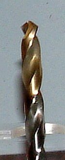

I use Stainless Steel Rod 8mm outside,6mm inside do your own conversion at purchase point.Drill the inside Dormer 6.3 mm marked actual 6.22(Never believe the markings)Cut to suit you make a dozen at a time.I use Stainless to lessen the chances of staining always there when you use Brasso on Corian with Brass spacers. Have fun and share rod puchase with friends,not sold in short lengths over the water this way. Peter
