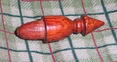

I have made friction fit finials. You must be precise when doing this, and there is no guarantee that it won't loosen up eventually. Here is one that I made recently for a slimline chasis. It didn't look right on the pen, so I removed it. It was as difficult to punch out as a standard finial.
<b>Image Insert:</b><br />
<br /> 30.75&nbsp;KB
