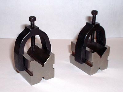

Make or buy a V-Block. Commonly used in metal working and drilling operations to hold round stock.

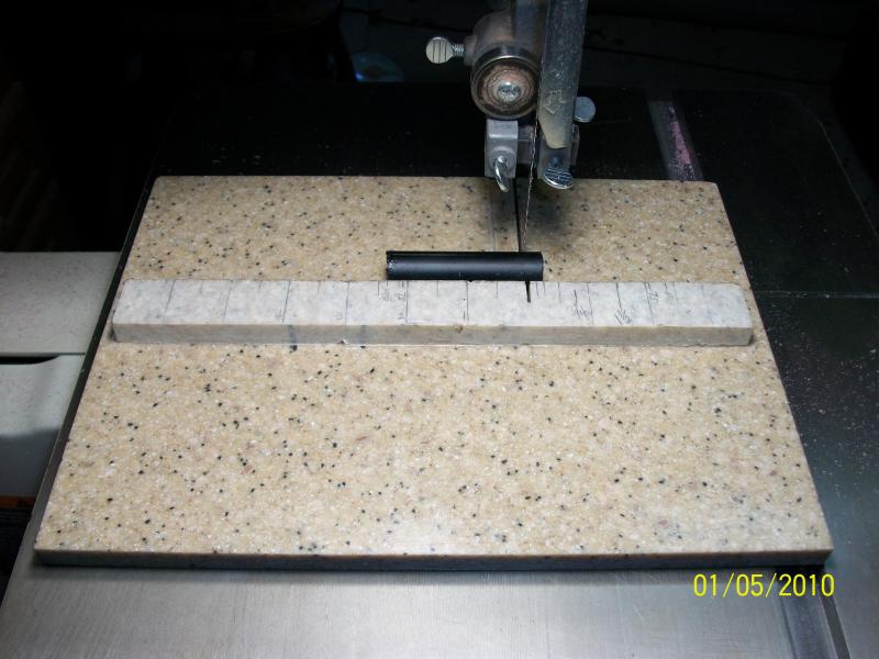

I use a corian sled with a kleat for the miter slot and one on top to hold the blank aginst. Works good for me. (For my band saw)
