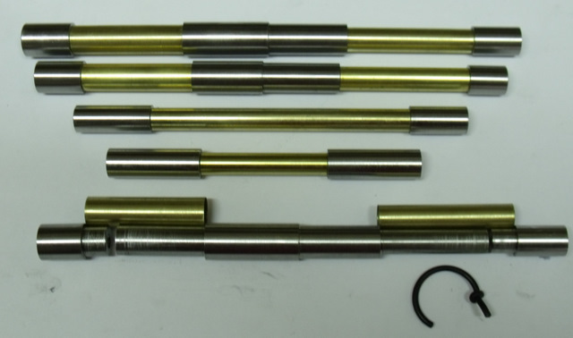

Here's what I've been working on for the last few days.:biggrin:
As I've got a metal lathe, it would be silly not to make my own bushes and stuff. But I wanted to go a step further than just making them a bit more accurate than stock bushings. Here are the changes I made...
1. Make them out of stainless steel. This would make them last longer, be more rigid, and less 'black' crud while wet sanding.
2. The outside 'finished' diameter to be long enough to be held in a chuck, but also 60deg end drilled for turning between centres. Also so that a special short tool rest isn't needed.
3. The inside portion(s) to almost fill the tube. This keeps the blank square even if the ends of the blank aren't pefectly squared. This works particularly well with pre-cast tubed blanks. Even if the ends are way off square, it is held parallel to the tube. Once the outside of the blank is made parallel to the tube, it is easy to re-chuck the blank and square the ends with a scraper or skew.
4. With capped pens, there is a flat surface to take a rubber o-ring to make closed ended pens. ( Like my old design )
I've made them for the Baron series ( Baron, Sedona, Navigator, Typhoon ), Jr series ( Gent, Statesman, Retro ) , Sierra (Click and Original), Aero, and Long Clicker.
I've made 3 sets so far, 1 has been spoken for, I'm keeping the first ( rough:redface:) set and the last set 'could' be up for grabs here if there is enough interest. Watch this space:wink: Just waiting for a technological breakthrough solution by our trusty leaders:biggrin:
If my lathe was CNC, then I'd also offer them for sale, but it's hard boring work so I'll just periodically make a set and just offer them for a trade for stuff.
LOL, just remember when you see these elsewhere, :wink::mad::tongue: who made them first!!!.:biggrin: Copyright my a.....!!!:biggrin:

Very nice work!!!
I gots to get me some of those!!!!:biggrin:
Hopefully i can make it to metal supermarket sometime soon!!
Quick question:
How do you drill the 60 degree in the ends??
Do you use a 60 degree center drill or cut it on the metal lathe?
Thanks for the inspiration!!
Andrew

Andrew, be like me and raid a skip for stock :biggrin: Too many people throw good stuff out for anyone to ever have to buy it:wink:
The ends are 60deg centre drilled then the parts are turned to size around these centres to keep them true. It's tough on lathe bearings to turn stainless between centres ( you have to really tighten the tailstock )and my next investment will definately be a collet chuck. My 3 and 4 jaw chucks are pretty 'close', but I wanted these to be spot on.

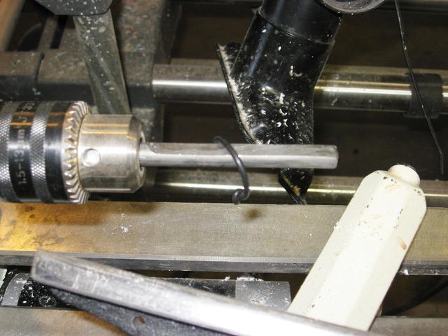

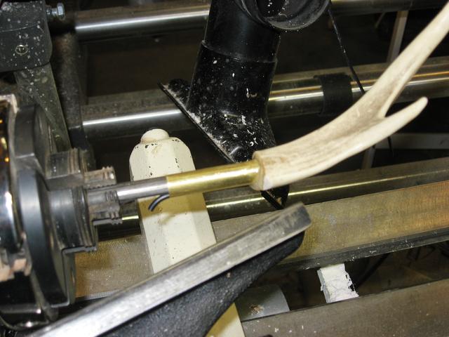

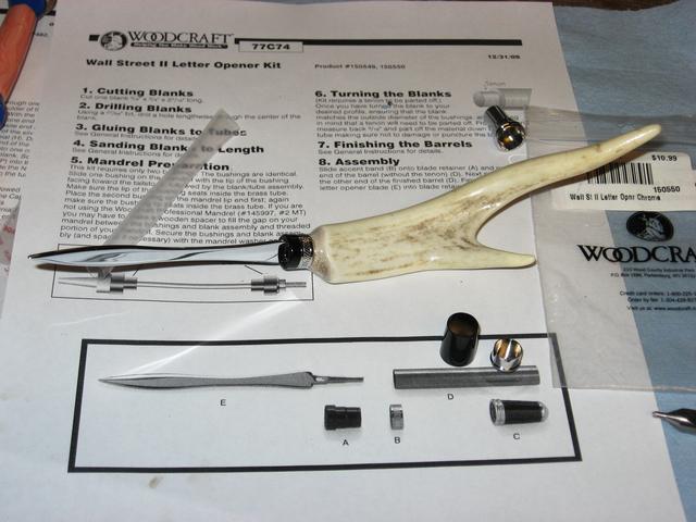

Your'e a day late and a dollar short. Wanted to make a letter opener with a small antler prong. Had to be closed ended. Having recalled a tutorial,, I looked it up and did it my way. Instead of a bold I used a 12" landscape spike(big a*** nail)...
If I waited a day I could have tried to talk you out of the third set..Oh well...
As a quick tip to all..browse through all the tutorials even if they don't apply to you interest or current projects...You never know when you'll hav an AhAAA moments an recall one....

Very neat idea there Skippy.
What are some of the dimensions (length only) of the top 2 bushing mandrels? The middle stepped bush in particular seems very long.
Like the idea of having stainless steel bushes, might have to brush up on my stainless turning skills.:rolleyes:
I did the middle bit like that for a few reasons. Main one was so they could be held in a chuck around this point for doing closed ended or just one blank at a time. Another was so as not to need a special short tool rest.
They 'worked out' at around 35mm per step. I say 'worked out' because my stock is similar length threaded rods. I'd centre drill the ends, rough off the threads, then one side would be turned ( rough)to the cap diameter and the other side to the max body diameter. Then I'd chop a bit off each end for the small bushes. Re-centre drill and then turn to final size between centres. :biggrin:

Steven; I have made some of my own between-center bushings and I tend to make the tube portion at least 1/2" (13mm).
PS. Some info I just figured out. I have an Imperial (inch) cross feed on my lathe. But a metric compound. Since my brain is programmed in inches, I did this calculation.
Set compound to 5.83 degrees and 1 mark on the compound is .0001"
Set compound to 30.54 degrees and 1 mark on the compound is .0005"
I only use these for finishing cuts. I is satisfying to hear the "pop" when removing the bushings!
Dang; I typoed the angle on the second line. It should be 30.54 NOT 2.054.

Thanks for that Steven, have just come in from the shed for lunch after having made my first set of Skippy's bushing mandrels.
I started with a set of Sierra bushes, as I wasn't too confident about my stainless skills. As it turned out it went OK, I made the inside the tube part of the bush 25mm long and the outside part as well. Centre drilled them with a #4 centre drill and tested them on the wood lathe, worked very well indeed.
BTW, I used my ER25 collet chuck for these, got that from Chronos in the UK (you can feed up to 16mm stock through that, mounted on a M39x4 backplate from Litte Machine Shop in the US, it's getting to be a small world!)
