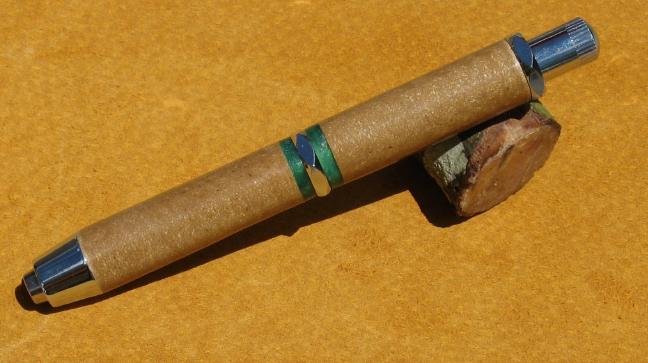

like the Chrome obnes from CUSA. The have the nut like center band that keeps the from rolling away and I just like the chrome better. I've made several now usingf left over decking material - Trex or what ever the brand is..Recycled plastics and vertually indidtructable. You can burnish with the flat of a skew and I've added ring of collored acrylic. On Purpose:wink:
