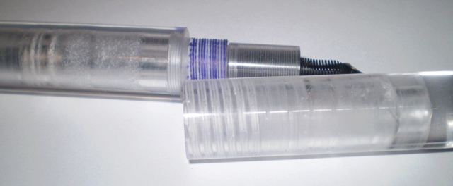

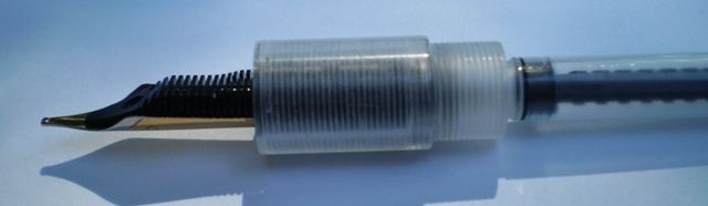

I think i've started with a reverse engineering idea. The section first, then the body, then the cap. All of the sizes must fit, so the section with the converter dictates pretty much everything else regarding size.
So to really address your question, "it depends"

Lou you lost me. What do you purpose to tap with the 10mm tap, the cap?
I use a 10mm x 1.0mm tap to thread the lower body to screw the front section into.
